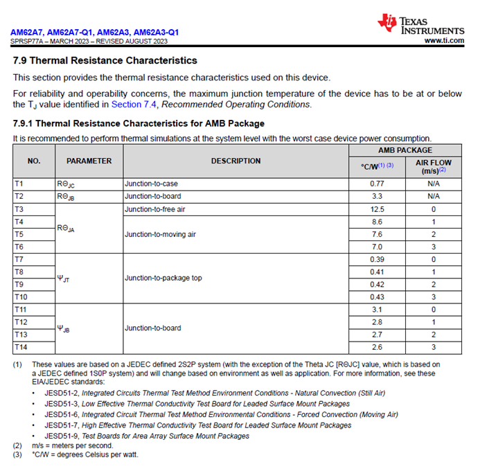

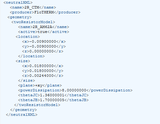

The thermal resistances of AM62A7 in different data source are not same,and which can be used for thermal simulation?
In the thermal model is at below, R_JC=1.36, R_JB=1.7
But in the data sheet https://www.ti.com/lit/ds/symlink/am62a7-q1.pdf?ts=1698213879249&ref_url=https%253A%252F%252Fwww.ti.com%252Fproduct%252FAM62A7-Q1is at below, R_JC=0.77, R_JB=3.3

    If the thermal resistances of AM62A7 in different data sources are not the same, it can be difficult to determine which value to use for thermal simulation. However, the values provided in the thermal model you have provided can be used as a starting point.
    The thermal model you have provided includes a value for the junction-to-case thermal resistance (R_JC) of 1.36°C/W and a value for the junction-to-board thermal resistance (R_JB) of 1.7°C/W. These values can be used to estimate the temperature rise of the device under different operating conditions.

  • Thanks for the answer, and I will conservatively use R_JC=1.36, R_JB=1.7 for the simulation.
