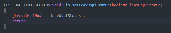

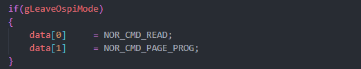

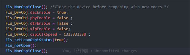

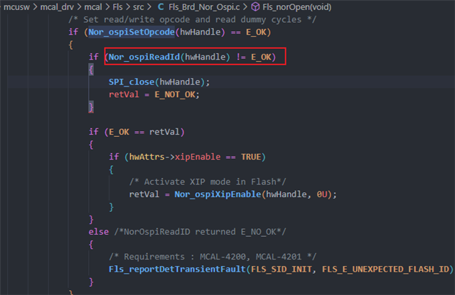

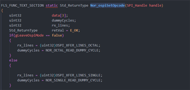

We are attempting to unmount the Nor flash device using the FLS driver under MCAL, in order to mount it properly on the SOC side. We followed the approach of the 'OSPILeaveConfigSPI()' function in the PDK to set the OSPI to the legacy SPI mode, but we are encountering errors. Could you please advise on how to configure it correctly for unmounting this device?
Here are the changes we made:
And we found that the error reported were in the following area,

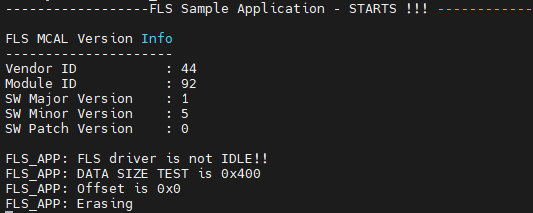

  • The version of our FLS driver is in the follow picture, and we have not found the `Fls_Close()` you mentioned.
    Can you please confirm if our versions are the same?

  • I need to load and unmount the same NOR flash. After the MCU reads the image from the NOR flash, I need to unmount it and then mount this NOR flash on the SOC. This is exactly what your sample code provides, except that I now need to convert the ospi driver from PDK to MCAL on the MCU side.

  • I don't understand mount and unmount here, The code that you are trying is to integrate and leave the OSPI in legacy mode. This is generally used when we are booting HLOS from OSPI. So once the MCU R5 reads the required images from OSPI it will leave the OSPI in legacy SPI mode so that linux can configure it in it's own way and can read the OSPI if required. Is that what you are trying to do ?
    and also i think we have integrated this in MCUSS DEMOS of can boot app i believe. Can you please look into that ,may be that is what you are expecting ?
  • This is exactly our initial problem. In the can boot app, we used the ospi driver from the PDK to set the OSPI to legacy SPI mode. Now, we want to use the ospi driver from the MCAL to set the OSPI driver to legacy mode.
  • what error are you facing ? can you share me the log after shifting the API to MCAL?
