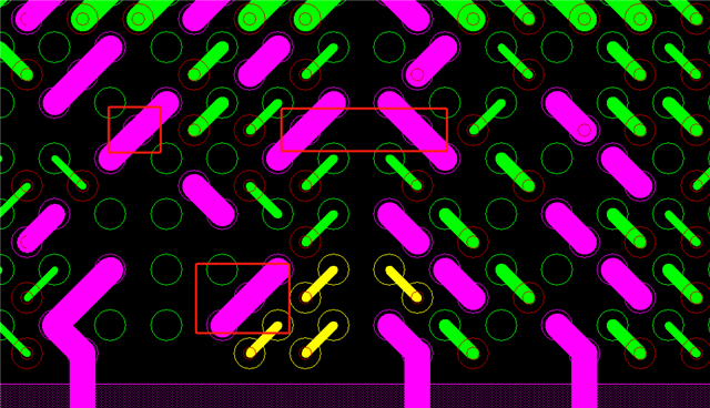

BGA区域走线时,能否两个gnd pin 共用一个gnd via?
工程师建议每个GND用自己的GND via。请看下面的回复。
Recommendation is for each GND ball to have its own GND via - as shown in TI's example designs (EVM, Starter Kit, etc). The minimizes the inductance of the GND return path for both power and high speed signal.
