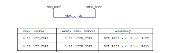

Rfb电阻 R150在sch里面没有看到?
文档有误,请参考下面的文档。
(2) The AM62 starter kit comes with the TPS6521904 PMIC by default, supporting VDD_CORE=0.85V. To support VDD_CORE=0.75V, the following changes are required: TPS6521904 PMIC needs to be replaced with TPS6521903, R699 needs to be uninstalled, and R123 needs to be mounted.
https://www.ti.com/lit/an/slvafd0b/slvafd0b.pdf
对应原理图说明。
