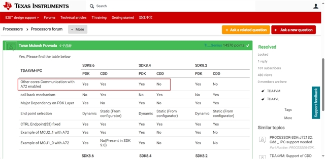

TDA4VM: CDDIPC doesn't support other cores to communicate with A72 on SDK8.4?
Part Number: TDA4VM
Now  I need to implement TDA4VM-MCU1_0 IPC communication on SDK8.4, but I saw a post on the E2E forum saying that CDDIPC doesn't support other cores to communicate with A72, is that actually the case? If that's the case, do I need to replace the SDK with the new version.
