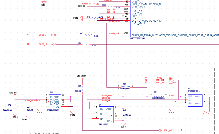

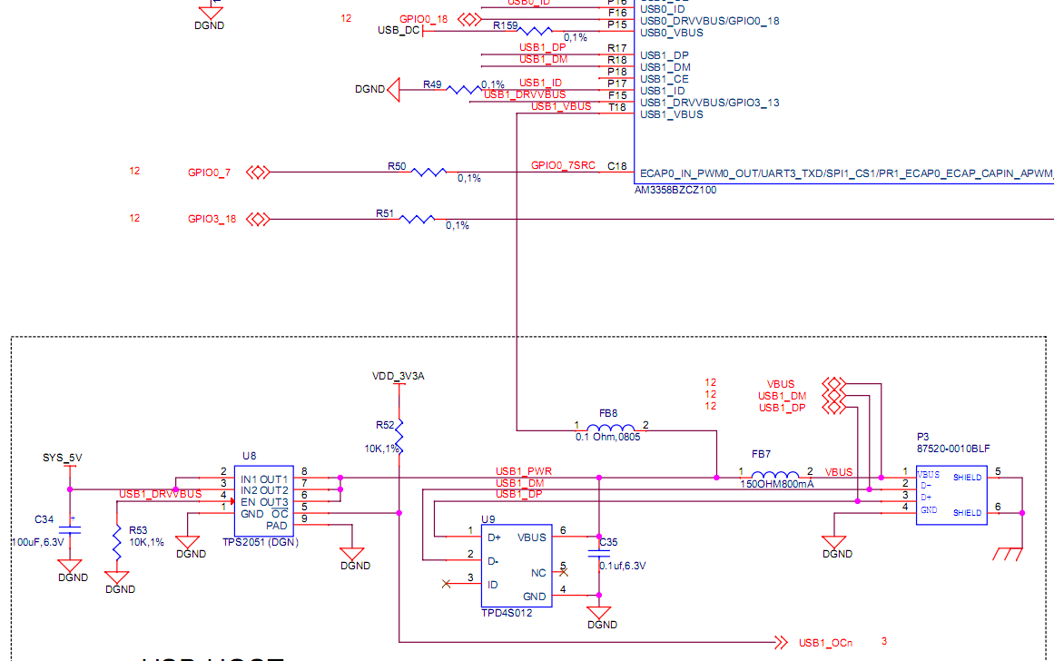

ti81xx_interrupt ti-sdk-6.0版本 中断一直打印,大家帮忙看看下面的文件,讨论出结果,谢谢。
Other Parts Discussed in Thread: TMDXEVM3358
         * The Mentor core doesn't debounce VBUS as needed
             * to cope with device connect current spikes. This
             * means it's not uncommon for bus-powered devices
             * to get VBUS errors during enumeration.
             * This is a workaround, but newer RTL from Mentor
             * seems to allow a better one: "re"-starting sessions
             * without waiting for VBUS to stop registering in
             * devctl.
            musb->int_usb &= ~MUSB_INTR_VBUSERROR;
            musb->xceiv->state = OTG_STATE_A_WAIT_VFALL;
            mod_timer(&musb->otg_workaround,
                        jiffies + POLL_SECONDS * HZ);
            WARNING("VBUS error workaround (delay coming)\n");  这句话会一直打印,目前猜测的是硬件的电压不太稳定,所以才会一直打印。
