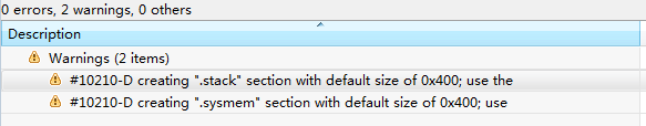

EVM6678LE开发板LOAD程序时出现错误,求解
下载程序时,出现如下错误:
C66xx_0: GEL Output: Invalidate All Cache...
C66xx_0: GEL Output: Invalidate All Cache... Done.
C66xx_0: GEL Output: GEL Reset...
C66xx_0: GEL Output: GEL Reset... Done.
C66xx_0: Loader: One or more sections of your program falls into a memory region that is not writable. These regions will not actually be written to the target. Check your linker configuration and/or memory map.
C66xx_0: Trouble Writing Register PC: (Error -1176 @ 0xD720) Unable to access device memory. Verify that the memory address is in valid memory. If error persists, confirm configuration, power-cycle board, and/or try more reliable JTAG settings (e.g. lower TCLK). (Emulation package 5.0.838.0)
C66xx_0: GEL Output: Disable all EDMA3 interrupts and events.
在编译程序时出现警告如附件所示:
请问,有没有可能是芯片RAM有问题?因为之前POST测试程序里,RAM测试的LED灯没有,或者是其他地方有问题呢?
