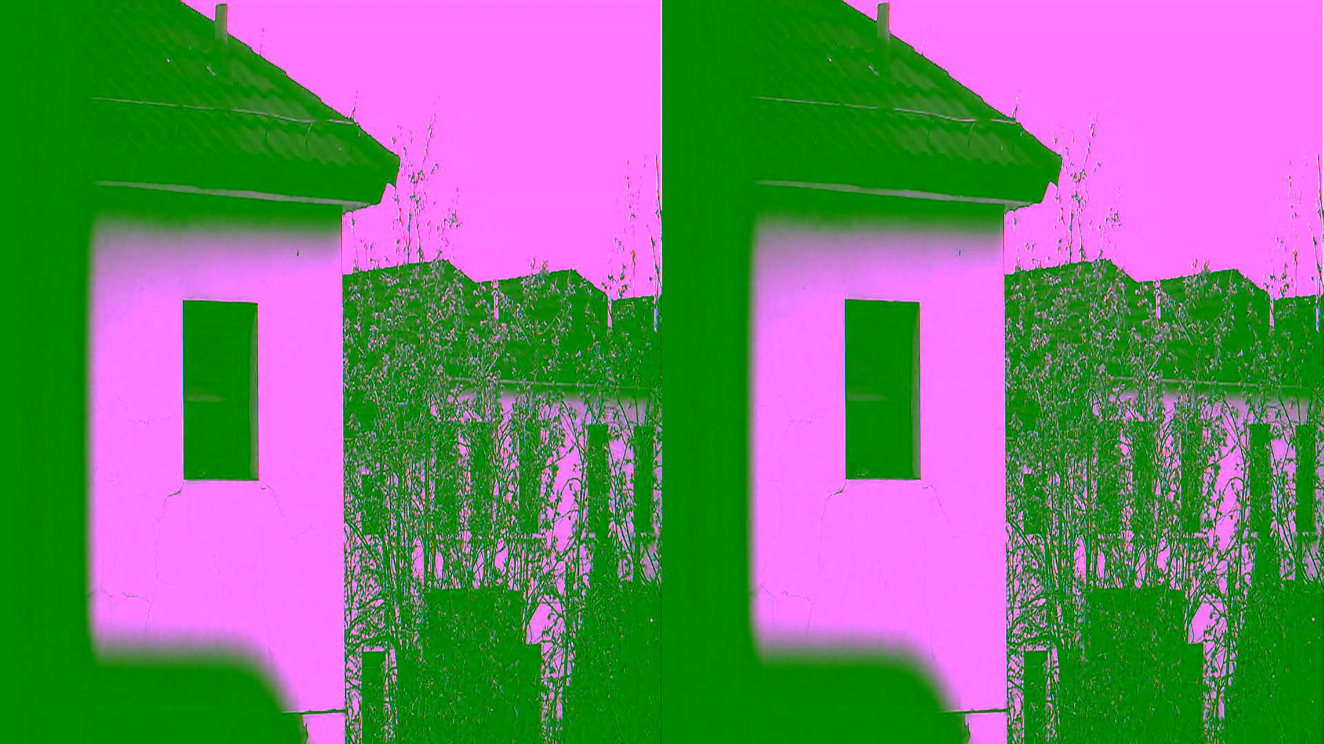

8168在link之间加了mpslcr 和 sclr之后视频变绿,没有缩放的那一路没事。下面附上截图和link结构,麻烦帮我分析下谢谢。

 skyMpSclrPrm.enableLineSkip=FALSE;  skyMpSclrPrm.inQueParams.prevLinkId=ipcFramesInVpssId;  skyMpSclrPrm.inQueParams.prevLinkQueId=0;  skyMpSclrPrm.numCh=1;  skyMpSclrPrm.outQueParams.nextLink=skySclrId;  //skyMpSclrPrm.ismpsclr=0;  skyMpSclrPrm.pathId=MP_SCLR_LINK_SC5; //#if 0  skySclrPrm.inQueParams.prevLinkId     = skyMpSclrId;  skySclrPrm.inQueParams.prevLinkQueId    = 0;  skySclrPrm.outQueParams.nextLink     = skyNsfId;  skySclrPrm.tilerEnable        = FALSE;  skySclrPrm.enableLineSkipSc       = TRUE;//FALSE;  //skySclrPrm.pathId=SCLR_LINK_SEC0_SC3;
 /* Specify Input and  Output FPS. Scalar link will drop frames as per */  /* the ratio of i/p and o/p FPS specified here        */    // skySclrPrm.inputFrameRate      = 60;    // skySclrPrm.outputFrameRate     = 2;
 /* Set Output Scaling at Scalar link, Here o/p is 352x288*/  /* Scaling mode used in the scalar. Two different scalling modes are supported. */  /*  SCLR_SCALE_MODE_RATIO   : Specify ratio of i/p to o/p for width and height*/  /*  SCLR_SCALE_MODE_ABSOLUTE : Absolute scale mode, provide width & height  */
 skySclrPrm.scaleMode        =DEI_SCALE_MODE_RATIO; //SCLR_SCALE_MODE_RATIO;  skySclrPrm.outScaleFactor.ratio.widthRatio.numerator = 1;  skySclrPrm.outScaleFactor.ratio.widthRatio.denominator = 1;  skySclrPrm.outScaleFactor.ratio.heightRatio.numerator = 1;  skySclrPrm.outScaleFactor.ratio.heightRatio.denominator = 1;  skySclrPrm.inputFrameRate=25;  skySclrPrm.outputFrameRate=25; //#endif  skyNsfPrm.bypassNsf = TRUE;  skyNsfPrm.tilerEnable = FALSE;  skyNsfPrm.inQueParams.prevLinkId = skySclrId;  skyNsfPrm.inQueParams.prevLinkQueId = 0;  skyNsfPrm.numBufsPerCh = 0;  skyNsfPrm.numOutQue = 1;  skyNsfPrm.inputFrameRate=25;  skyNsfPrm.outputFrameRate=25;  skyNsfPrm.outQueParams[0].nextLink = mergeId;
   mergePrm.numInQue       = 2;  mergePrm.inQueParams[0].prevLinkId   = skyNsfId;
 mergePrm.inQueParams[0].prevLinkQueId = 0;  mergePrm.inQueParams[1].prevLinkId   = skyIpcFramesInVpssId;
 mergePrm.inQueParams[1].prevLinkQueId = 0;  mergePrm.notifyNextLink      = TRUE;  mergePrm.outQueParams.nextLink    = skyIpcFramesOutVpssId1;
 skyIpcFramesOutVpssPrm1.baseCreateParams.inQueParams.prevLinkId    = mergeId;  skyIpcFramesOutVpssPrm1.baseCreateParams.inQueParams.prevLinkQueId   = 0;  skyIpcFramesOutVpssPrm1.baseCreateParams.numOutQue       = 1;  skyIpcFramesOutVpssPrm1.baseCreateParams.outQueParams[0].nextLink   = skyIpcFramesInVideoId1;  skyIpcFramesOutVpssPrm1.baseCreateParams.numChPerOutQue[0]     = 2;  skyIpcFramesOutVpssPrm1.baseCreateParams.noNotifyMode      = FALSE;  skyIpcFramesOutVpssPrm1.baseCreateParams.notifyPrevLink      = TRUE;  skyIpcFramesOutVpssPrm1.baseCreateParams.notifyNextLink      = TRUE;  skyIpcFramesOutVpssPrm1.baseCreateParams.inputFrameRate=25;  skyIpcFramesOutVpssPrm1.baseCreateParams.outputFrameRate=25;
 skyIpcFramesInVideoPrm1.baseCreateParams.inQueParams.prevLinkId    = skyIpcFramesOutVpssId1;  skyIpcFramesInVideoPrm1.baseCreateParams.inQueParams.prevLinkQueId = 0;  skyIpcFramesInVideoPrm1.baseCreateParams.numOutQue       = 1;  skyIpcFramesInVideoPrm1.baseCreateParams.outQueParams[0].nextLink  = encId;  skyIpcFramesInVideoPrm1.baseCreateParams.numChPerOutQue[0]     = 2;  skyIpcFramesInVideoPrm1.baseCreateParams.noNotifyMode      = FALSE;  skyIpcFramesInVideoPrm1.baseCreateParams.notifyNextLink      = TRUE;  skyIpcFramesInVideoPrm1.baseCreateParams.notifyPrevLink      = TRUE;  skyIpcFramesInVideoPrm1.baseCreateParams.equallyDivideChAcrossOutQues = FALSE;  skyIpcFramesInVideoPrm1.baseCreateParams.inputFrameRate=25;  skyIpcFramesInVideoPrm1.baseCreateParams.outputFrameRate=25;
   {   encPrm.chCreateParams[0].format        = SCLR_ENCFORMAT;   encPrm.chCreateParams[0].profile       = SCLR_PROFILE;   encPrm.chCreateParams[0].dataLayout       = IVIDEO_FIELD_SEPARATED;   encPrm.chCreateParams[0].fieldMergeEncodeEnable    = FALSE;   encPrm.chCreateParams[0].enableAnalyticinfo     = 0;   encPrm.chCreateParams[0].enableWaterMarking     = 0;   encPrm.chCreateParams[0].maxBitRate       = -1;   encPrm.chCreateParams[0].encodingPreset      = 3;//XDM_USER_DEFINED;   encPrm.chCreateParams[0].rateControlPreset     = IVIDEO_LOW_DELAY;///IVIDEO_USER_DEFINED;vbr 码率控制方式   encPrm.chCreateParams[0].enableHighSpeed     = FALSE;   encPrm.chCreateParams[0].enableSVCExtensionFlag    = FALSE;   encPrm.chCreateParams[0].numTemporalLayer     = 0;   encPrm.chCreateParams[0].defaultDynamicParams.intraFrameInterval = 30;//SCLR_INTRAFRAMEINTERVAL;   encPrm.chCreateParams[0].defaultDynamicParams.interFrameInterval = 1;   encPrm.chCreateParams[0].defaultDynamicParams.inputFrameRate  = SCLR_FRAME_RATE;   encPrm.chCreateParams[0].defaultDynamicParams.targetBitRate   = SCLR_TARGETBITRATE;////16m 最大   encPrm.chCreateParams[0].defaultDynamicParams.mvAccuracy   = IVIDENC2_MOTIONVECTOR_QUARTERPEL;   encPrm.chCreateParams[0].defaultDynamicParams.rcAlg     = SCLR_RCALG;   encPrm.chCreateParams[0].defaultDynamicParams.qpMin     = 10;   encPrm.chCreateParams[0].defaultDynamicParams.qpMax     = 40;   encPrm.chCreateParams[0].defaultDynamicParams.qpInit    = -1;   encPrm.chCreateParams[0].defaultDynamicParams.vbrDuration   = 8;   encPrm.chCreateParams[0].defaultDynamicParams.vbrSensitivity    = 0;  } //#if 0  {  encPrm.chCreateParams[1].format        = JPGENC_ENCFORMAT;  encPrm.chCreateParams[1].profile       = 88;  encPrm.chCreateParams[1].dataLayout       = IVIDEO_FIELD_SEPARATED;  encPrm.chCreateParams[1].fieldMergeEncodeEnable    = FALSE;  encPrm.chCreateParams[1].enableAnalyticinfo     = 0;  encPrm.chCreateParams[1].enableWaterMarking     = 0;  encPrm.chCreateParams[1].maxBitRate       = -1;  encPrm.chCreateParams[1].encodingPreset      = 0;  encPrm.chCreateParams[1].rateControlPreset     = 0;  encPrm.chCreateParams[1].enableSVCExtensionFlag    = 0;  encPrm.chCreateParams[1].numTemporalLayer     = 0;    encPrm.chCreateParams[1].defaultDynamicParams.intraFrameInterval = 25;  encPrm.chCreateParams[1].defaultDynamicParams.targetBitRate   = 1000*1000;  encPrm.chCreateParams[1].defaultDynamicParams.interFrameInterval = 0;  encPrm.chCreateParams[1].defaultDynamicParams.mvAccuracy   = 0;  encPrm.chCreateParams[1].defaultDynamicParams.inputFrameRate  = 1;  encPrm.chCreateParams[1].defaultDynamicParams.qpMin     = 51;  encPrm.chCreateParams[1].defaultDynamicParams.qpMax     = -1;  encPrm.chCreateParams[1].defaultDynamicParams.qpInit    = 88;  encPrm.chCreateParams[1].defaultDynamicParams.vbrDuration   = 0;  encPrm.chCreateParams[1].defaultDynamicParams.vbrSensitivity  = 0;
//#endif  encPrm.inQueParams.prevLinkId = skyIpcFramesInVideoId1;  encPrm.inQueParams.prevLinkQueId = 0;  encPrm.outQueParams.nextLink = ipcBitsOutVideoId;  encPrm.numBufPerCh[0]   = 0;  encPrm.numBufPerCh[1]   =0;
 ipcBitsOutVideoPrm.baseCreateParams.inQueParams.prevLinkId  = encId;  ipcBitsOutVideoPrm.baseCreateParams.inQueParams.prevLinkQueId = 0;  ipcBitsOutVideoPrm.baseCreateParams.numOutQue     = 1;  ipcBitsOutVideoPrm.baseCreateParams.outQueParams[0].nextLink = ipcBitsInHostId;  ipcBitsOutVideoPrm.baseCreateParams.numChPerOutQue[0]   = 2;  ipcBitsOutVideoPrm.baseCreateParams.noNotifyMode     = FALSE;  ipcBitsOutVideoPrm.baseCreateParams.notifyNextLink     = TRUE;  ipcBitsOutVideoPrm.baseCreateParams.notifyPrevLink     = TRUE;  ipcBitsOutVideoPrm.baseCreateParams.inputFrameRate    = 25;  ipcBitsOutVideoPrm.baseCreateParams.outputFrameRate    = 25;
 ipcBitsInHostPrm.baseCreateParams.inQueParams.prevLinkId  = ipcBitsOutVideoId;  ipcBitsInHostPrm.baseCreateParams.inQueParams.prevLinkQueId  = 0;  ipcBitsInHostPrm.baseCreateParams.numOutQue      = 1;  ipcBitsInHostPrm.baseCreateParams.outQueParams[0].nextLink = SYSTEM_LINK_ID_INVALID;  ipcBitsInHostPrm.baseCreateParams.numChPerOutQue[0]    = 2;  ipcBitsInHostPrm.baseCreateParams.notifyNextLink   = FALSE;  ipcBitsInHostPrm.baseCreateParams.notifyPrevLink   = TRUE;  ipcBitsInHostPrm.baseCreateParams.noNotifyMode    = FALSE;  ipcBitsInHostPrm.baseCreateParams.inputFrameRate    = 25;  ipcBitsInHostPrm.baseCreateParams.outputFrameRate  =25;
 bitsinsclrInitCreateParams_BitsInHLOS(&ipcBitsInHostPrm, ipcBitsInHostId);  System_linkCreate(captureId, &capturePrm, sizeof(capturePrm));  System_linkControl(captureId, CAPTURE_LINK_CMD_CONFIGURE_VIP_DECODERS, NULL, 0, TRUE);
 System_linkCreate(nsfId  , &nsfPrm  , sizeof(nsfPrm));  System_linkCreate(nsfId1 , &nsfPrm1  , sizeof(nsfPrm1));      System_linkCreate(ipcFramesOutVpssId  , &ipcFramesOutVpssPrm    , sizeof(ipcFramesOutVpssPrm));  System_linkCreate(skyIpcFramesOutVpssId  , &skyIpcFramesOutVpssPrm   , sizeof(skyIpcFramesOutVpssPrm));  System_linkCreate(ipcFramesInHostId  , &ipcFramesInHostPrm   , sizeof(ipcFramesInHostPrm));  System_linkCreate(skyIpcFramesInHostId  , &skyIpcFramesInHostPrm  , sizeof(skyIpcFramesInHostPrm));  System_linkGetInfo(ipcFramesInHostId, &framesProducerLinkInfo);  OSA_assert(framesProducerLinkInfo.numQue == 1);  ipcFramesOutHostPrm.inQueInfo = framesProducerLinkInfo.queInfo[0];
 System_linkGetInfo(skyIpcFramesInHostId, &skyFramesProducerLinkInfo);
 OSA_assert(skyFramesProducerLinkInfo.numQue == 1);  skyIpcFramesOutHostPrm.inQueInfo = skyFramesProducerLinkInfo.queInfo[0];
 System_linkCreate(ipcFramesOutHostId  , &ipcFramesOutHostPrm    , sizeof(ipcFramesOutHostPrm));  System_linkCreate(skyIpcFramesOutHostId  , &skyIpcFramesOutHostPrm   , sizeof(skyIpcFramesOutHostPrm));  System_linkCreate(ipcFramesInVpssId , &ipcFramesInVpssPrm , sizeof(ipcFramesInVpssPrm) );  System_linkCreate(skyIpcFramesInVpssId , &skyIpcFramesInVpssPrm , sizeof(skyIpcFramesInVpssPrm) );
   System_linkCreate(skyMpSclrId, &skyMpSclrPrm, sizeof(skyMpSclrPrm));  System_linkCreate(skySclrId, &skySclrPrm, sizeof(skySclrPrm));
   System_linkCreate(skyNsfId, &skyNsfPrm, sizeof(skyNsfPrm));  System_linkCreate(mergeId , &mergePrm  , sizeof(mergePrm));  System_linkCreate(skyIpcFramesOutVpssId1 , &skyIpcFramesOutVpssPrm1 , sizeof(skyIpcFramesOutVpssPrm1) );  System_linkCreate(skyIpcFramesInVideoId1 , &skyIpcFramesInVideoPrm1 , sizeof(skyIpcFramesInVideoPrm1) );  System_linkCreate(encId, &encPrm, sizeof(encPrm));  System_linkCreate(ipcBitsOutVideoId, &ipcBitsOutVideoPrm, sizeof(ipcBitsOutVideoPrm));  System_linkCreate(ipcBitsInHostId, &ipcBitsInHostPrm, sizeof(ipcBitsInHostPrm));
 System_linkStart(captureId);
 System_linkStart(nsfId);  System_linkStart(nsfId1);
      System_linkStart(ipcFramesOutVpssId);  System_linkStart(skyIpcFramesOutVpssId);  System_linkStart(ipcFramesInHostId);
 System_linkStart(skyIpcFramesInHostId);
 System_linkStart(ipcFramesOutHostId);  System_linkStart(skyIpcFramesOutHostId);  System_linkStart(ipcFramesInVpssId);  System_linkStart(skyIpcFramesInVpssId);
   System_linkStart(skyMpSclrId);  System_linkStart(skySclrId);  System_linkStart(skyNsfId);  System_linkStart(mergeId);
 System_linkStart(skyIpcFramesOutVpssId1);  System_linkStart(skyIpcFramesInVideoId1);  System_linkStart(encId);  System_linkStart(ipcBitsOutVideoId);  System_linkStart(ipcBitsInHostId);  updateBitrateParams();
