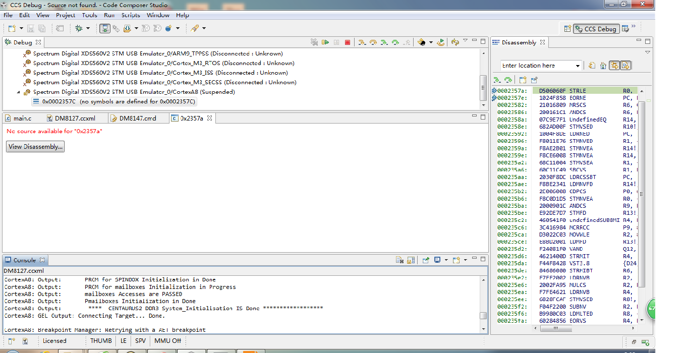

Connecting Target...
CortexA8: Output: **** CENTAURUS2 DDR3 System_Initialisation IS in progress ..........
CortexA8: Output: **** CENTAURUS2 ALL ADPLL INIT IS In Progress .........
CortexA8: GEL: Error while executing OnTargetConnect(): Target failed to read memory at 0x481C5114 at (*((unsigned int *) (Base_Address+0x4))|0x00800000) [IPNC_A8_DDR3.gel:675] at PLL_Clocks_Config((0x481C5000+0x110), CLKIN, N, M, M2, 0x00000801) [IPNC_A8_DDR3.gel:1084] at cmdL3PLL(CLKIN, 19, 800, 4) [IPNC_A8_DDR3.gel:1043] at PLL_SETUP() [IPNC_A8_DDR3.gel:99] at ALL_ADPLL_CLOCKS_ENABLE_API() [IPNC_A8_DDR3.gel:30] at HDVPSSInit() [IPNC_A8_DDR3.gel:21] at OnTargetConnect() .
你好,这个是我连接开发板时候遇到的问题。gel文件是IPNC_A8_DDR3.gel
错误信息显示L3的时钟配置出现问题。开发板+原配的代码应该不会出现这种情况。
- 你看看在script->这个下拉菜单里面其他的选项是否能用。
- Run->reset一下看看能不能用
- 先不要load Gel文件,先连接A8,再load Gel。从script这里手工运行。
