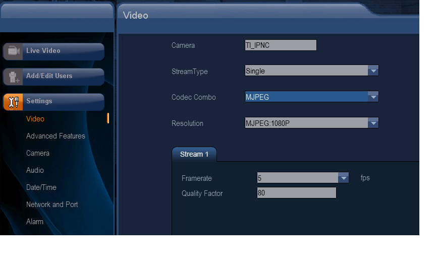

  • 如果按appro里面设置为单jpg输出格式,有没有作如下更改
    for (i = 0; i < VENC_PRIMARY_CHANNELS; i++)//i < VENC_PRIMARY_CHANNELS
    pLinkChPrm = &encPrm.chCreateParams[i];
    pLinkDynPrm = &pLinkChPrm->defaultDynamicParams;
    pChPrm = &gVencModuleContext.vencConfig.encChannelParams[i];
    pDynPrm = &pChPrm->dynamicParam;
    gUI_mcfw_config.demoCfg.codec_combo = 2;//修改了一处
    switch(gUI_mcfw_config.demoCfg.codec_combo) {
    编译都不影响,用VLC能看到MJPEG流
    运行提示发出的流如下
    Initializing...
    ...done initializing
    Play this stream using the URL:
    rtsp://192.168.1.168:8555/PSIA/Streaming/channels/0?videoCodecType=MJPEG
    (We use port 8302 for optional RTSP-over-HTTP tunneling.)
    ApproDrvInit: 9
    queue id:131076
    Initializing...
    rtsp://192.168.1.168:8556/PSIA/Streaming/channels/2?videoCodecType=H.264
    (We use port 8303 for optional RTSP-over-HTTP tunneling.)
    ApproDrvInit: 2
    queue id:131076
    Initializing...
    rtsp://192.168.1.168:8553/PSIA/Streaming/channels/1?videoCodecType=MPEG4
    其中
    这两个流用VLC是不能显示异常
    用ps命令查看后台的进程仍有3个
    601 root 67000 S ./wis-streamer -s
    602 root 90444 R ./wis-streamer -s
    603 root 67000 S ./wis-streamer -s
    请问开机软件如何设置为单一的jpeg或多个都为jpg参数设置?而wis-streamer -s是在哪里开启相应的进程?
