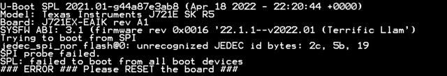

After the above operations, I switched SW1 BOOTMODE to xSPI-1S, and after testing, the system can boot from NOR Flash.
Because the default NOR Flash on the platform is Infineon S28HS512TGABHM010.
But my goal is to use MXIC MX25UM256 and MICRON MT35XU256. So I replaced the Infineon S28HS512TGABHM010 with the MICRON MT35XU256.
After the replacement was completed, I tried booting through MICRON MT35XU256, but the boot failed and the UART printed out the following information.
Could you let me know how to fix this problem? Which SDK file does the Flash ID belong to? Which code should I modify?
