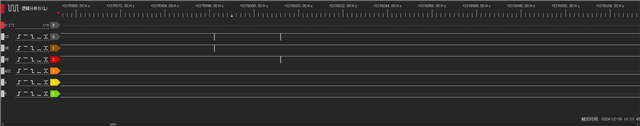

我在SK-AM62A-LP 官方开发板上利用GPMC接口驱动OLED屏,采用以下接法:NOR FLASH,8位,地址数据不复用的方式。但测试时序时发现两个问题:
1、时序没有按照寄存器配置的值输出信号。
2、在写操作时,会触发到OE即读使能信号。
我的测试方法如下:
在板子跑起来后,在串口终端输出如下命令:
写操作命令:devmem2 0x503FFFF8 b 0xda
读操作命令:devmem2 0x50400000 b
请帮忙分析一下原因。
详细看下面的抓图。
图1:写命令触发到OE信号,然后才是WE信号。
图2:CS值异常,没有按配置的输出。我配置的CS值是480ns,但输出的信号CS值只有70ns。同样WE值也不对。
图3:串口写操作,读操作命令

[ 1.215155] gpmc cs1 =====================before gpmc_cs_program_settings=====================

[ 1.439303] gpmc_cs_program_settings(1955): cs=1, GPMC_CS_CONFIG1=0x00000000,cjk1216
[ 1.447224] GPMC CS1: cs_on : 1 ticks, 40 ns (was 1 ticks) 30 ns
[ 1.454881] GPMC CS1: cs_rd_off : 23 ticks, 920 ns (was 16 ticks) 900 ns
[ 1.462537] GPMC CS1: cs_wr_off : 12 ticks, 480 ns (was 16 ticks) 480 ns
[ 1.470192] GPMC CS1: adv_on : 1 ticks, 40 ns (was 4 ticks) 30 ns
[ 1.477847] GPMC CS1: adv_rd_off : 2 ticks, 80 ns (was 5 ticks) 45 ns
[ 1.485501] GPMC CS1: adv_wr_off : 2 ticks, 80 ns (was 6 ticks) 45 ns
[ 1.493156] GPMC CS1: adv_aad_mux_on : 0 ticks, 0 ns (was 1 ticks) 0 ns
[ 1.500811] GPMC CS1: adv_aad_mux_rd_off: 0 ticks, 0 ns (was 2 ticks) 0 ns
[ 1.508554] GPMC CS1: adv_aad_mux_wr_off: 0 ticks, 0 ns (was 2 ticks) 0 ns
[ 1.516297] GPMC CS1: oe_on : 2 ticks, 80 ns (was 6 ticks) 55 ns
[ 1.523955] GPMC CS1: oe_off : 13 ticks, 520 ns (was 16 ticks) 495 ns
[ 1.531614] GPMC CS1: oe_aad_mux_on : 0 ticks, 0 ns (was 1 ticks) 0 ns
[ 1.539269] GPMC CS1: oe_aad_mux_off : 0 ticks, 0 ns (was 3 ticks) 0 ns
[ 1.546924] GPMC CS1: we_on : 2 ticks, 80 ns (was 5 ticks) 45 ns
[ 1.554578] GPMC CS1: we_off : 12 ticks, 480 ns (was 16 ticks) 450 ns
[ 1.562233] GPMC CS1: rd_cycle : 24 ticks, 960 ns (was 17 ticks) 930 ns
[ 1.569888] GPMC CS1: wr_cycle : 13 ticks, 520 ns (was 17 ticks) 510 ns
[ 1.577543] GPMC CS1: access : 13 ticks, 520 ns (was 15 ticks) 505 ns
[ 1.585198] GPMC CS1: page_burst_access: 0 ticks, 0 ns (was 1 ticks) 0 ns
[ 1.592852] GPMC CS1: bus_turnaround : 0 ticks, 0 ns (was 0 ticks) 0 ns
[ 1.600506] GPMC CS1: cycle2cycle_delay: 1 ticks, 40 ns (was 0 ticks) 30 ns
[ 1.608161] GPMC CS1: wr_data_mux_bus : 0 ticks, 0 ns (was 7 ticks) 0 ns
[ 1.615815] GPMC CS1: wr_access : 0 ticks, 0 ns (was 15 ticks) 0 ns
[ 1.623471] GPMC CS1: wait_monitoring : 0 ticks, 0 ns (was 0 ticks) 0 ns
[ 1.631128] GPMC CS1: clk_activation : 0 ticks, 0 ns (was 0 ticks) 0 ns
[ 1.638783] GPMC CS1 CLK period is 40 ns (div 1)

[ 2.038401] gpmc,bus-turnaround-ns = <0>; /* 0 ns - 0 ns; 0 ticks */
[ 2.044901] gpmc,cycle2cycle-delay-ns = <40>; /* 1 ns - 40 ns; 1 ticks */
[ 2.051847] gpmc,wait-monitoring-ns = <0>; /* 0 ns - 0 ns; 0 ticks */
[ 2.058435] gpmc,clk-activation-ns = <0>; /* 0 ns - 0 ns; 0 ticks */
[ 2.064934] gpmc,wr-data-mux-bus-ns = <0>; /* 0 ns - 0 ns; 0 ticks */
[ 2.071521] gpmc,wr-access-ns = <0>; /* 0 ns - 0 ns; 0 ticks */
[ 2.078058] omap-gpmc 3b000000.memory-controller: gpmc_probe_generic_child(2372): GPMC_CS_CONFIG1=0x00000000,cjk1216
[ 2.088834] omap-gpmc 3b000000.memory-controller: gpmc_probe_generic_child(2375): GPMC_CS_CONFIG7=0x00000850,cjk1216
[ 2.099600] omap-gpmc 3b000000.memory-controller: gpmc_probe_generic_child(2377): end ok,cjk1216

  • 以上两个问题已解决。
    现在遇到新的问题:
    1、我用GPMC_A22引脚连接到OLED的C/D 引脚(这个引脚低电平表示cmd,高电平表示data)。GPMC基地址是0x50000000。因此由基地址向左偏移22位即,0x50000000+(1<<22)=0x50400000,向这个地址写入值就能拉高GPMC_A22,表示这个值是data。然后向0x50400000-0x2=0x503ffffe地址写入值就拉低GPMC_A22,表示这个值是cmd。但现在的问题是:我将0x503ffffe ~ 0x50400001的地址范围用devm_ioremap_resource函数映射后,将映射后的cmd地址写值,再读映射后的data地址,得到的值等于cmd值,例如我写cmd=0xda,读data正确应该是0x01但却读到0xda。而且读全部的映射地址,值都是0xda,这是什么原因,哪里不对呢?
    2、GPMC CONFIG2~CONFIG6 寄存器每个时序参数最大只支持5bit即31个clk,可配置时序范围小,我的OLED屏的读写时序要求,最大值是NRD_CYCLE=800ns,最小是NCS_WR_SETUP=8ns。以最大800ns计算,800/31=25.8ns,即1个clk的最小精度只能是25ns,这个精度比最小的值NCS_WR_SETUP还要大。如何解决好?
    我的dtsi配置如下:

  • 您好
    AM62x 器件有一个显示子系统。 为什么要将 OLED 屏幕连接到 GPMC 接口、而不连接到 DSS?
  • 我的问题1,2都已解决。
    因为GPMC才能提供 OLED所需要的时序输出,OLED是I-80接口的。只是问题2时序配置范围5bit是有限制的。
  • 您好
    通常不会执行该测试、但您可以通过增加两个可用时钟源中任一个的分频器值来减慢 GPMC FCLK 的速度。 GPMC_CLKSEL 寄存器-选择 GPMC 时钟源 MAIN_PLL0_HSDIV3_CLKOUT (典型值133Mhz)或 MAIN_PLL2_HSDIV7_CLKOUT (典型值100Mhz) 针对任何时钟增加 HSDIV 分频器、直到 FCLK 足够慢、能够满足您的时序要求。 另一个可以使用的工具是 GPMC_CONFIG1_n 寄存器中的 TIMEPARAGRANULARITY 位。 设置该位会使每个 GPMC 时序的计数器加倍-有效地为每个时序参数提供最大值(31*2)而不是31clk 请参阅 https://dev.ti.com/sysconfig 上 AM62A 的 AM6X 时钟树(1.1.2)
