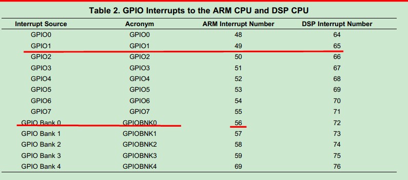

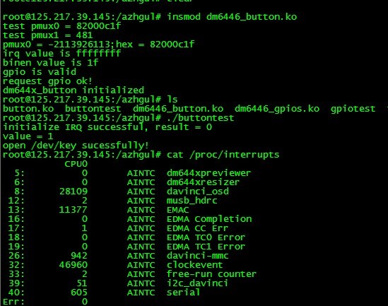

DM6446 GPIO中断
我申请中断,打印的信息显示申请成功,也能看到DM644X_GPIO_BUTTON的变化
但是却在 cat /proc/interrupt中看不到响应的中断号
也无法进入中断例程;请各位指教下~~~
程序如下,打印信息如图所示。

#define DM6446_GPIO_BASE 0x01C67000
//#define BINTEN (DM6446_GPIO_BASE + 0x8) //GPIO Interrupt Per Bank Enable
#define GPIO_REG(reg) (*(int *__iomem) IO_ADDRESS(reg))
#define IRQ1 0x01C4800C // Interrupt Request Status Register
#define EINT1 0x01C4801C // Interrupt Enable Register
#define INTPRI6 0x01C48048 // Interrupt Proirty
#define EABASE 0x01C48024 // Interrupt Entry Table Base Address
#define IRQENTRY 0x01C48047 // Entry Address for Valid IRQ
#define DEVICE_NAME "buttontest"   /*定义设备驱动的名字,或设备节点名称*/
#define BUTTON_MAJOR 200 /*使用 cat /proc/devices查看不要和存在的char节点重复*/
/*my app gpio define*/
#define DM644X_GPIO_BUTTON         3    /*GPIO3*/
//#define DM644X_GPIO_INIT IRQ_GPIO3
#define DM644X_GPIO_INIT 51

  gpio_direction_input(DM644X_GPIO_BUTTON);
      set_irq_type(DM644X_GPIO_INIT, IRQ_TYPE_EDGE_RISING);     //RISING   or  Edge Falling type
  disable_irq(DM644X_GPIO_INIT);
  enable_irq(DM644X_GPIO_INIT);
  //set_irq_type(irq_number, IRQ_TYPE_EDGE_FALLING);
  //int test;
//printk("open gpio,here is driver\n");
//if(gpio_is_valid(DM644X_GPIO_BUTTON) < 0)
// printk("gpio is invalid\n");
// return -EINVAL;
//printk("gpio is valid\n");
     // test = gpio_request(DM644X_GPIO_BUTTON, "buttons_interrupt");
 // if(test < 0 )
// printk("failed to request gpio\n");
// return -EINVAL;
// printk("request gpio ok!\n");
      //irq_number = gpio_to_irq(DM644X_GPIO_BUTTON);
      //printk(KERN_INFO "irq_number = %d\n", irq_number);
     // gpio_direction_input(DM644X_GPIO_BUTTON);
     // set_irq_type(IRQ_GPIO4, IRQF_TRIGGER_HIGH);     //RISING   or  Edge Falling type
      //disable_irq(IRQ_GPIO4);
  //enable_irq(IRQ_GPIO4);
  //gpio_direction_input(DM644X_GPIO_BUTTON);
      //result = request_irq((gpio_to_irq(DM644X_GPIO_BUTTON)), buttons_interrupt, 0, "button", "key");
  //result = request_irq((gpio_to_irq(DM644X_GPIO_BUTTON)), buttons_interrupt, SA_INTERRUPT, DEVICE_NAME, NULL);
  //result = request_irq(DM644X_GPIO_INIT,buttons_interrupt,SA_INTERRUPT,DEVICE_NAME,NULL);
  result = request_irq(DM644X_GPIO_INIT,buttons_interrupt,SA_INTERRUPT,"buttontest","key");
      if (result < 0)
             printk(KERN_INFO "Cannot initialize IRQ \n");
             return result;
      printk(KERN_INFO "initialize IRQ successful, result = %d\n", result);
      value = gpio_get_value(DM644X_GPIO_BUTTON);
      printk(KERN_INFO "value = %d\n", value);
      return 0;/*该函数可以什么都不做,也可以加入类似初始化的设置*/

static int __init davinci_dm644x_button_open(void) /*内核初始化会调用该函数*/
      int ret;
  int test;
unsigned long pmux0;
unsigned long pmux1;
//board_setup_psc(DAVINCI_GPSC_ARMDOMAIN, DAVINCI_LPSC_GPIO,1);
davinci_psc_config(DAVINCI_GPSC_ARMDOMAIN, DAVINCI_LPSC_GPIO, 1);
//davinci_psc_config(DAVINCI_GPSC_ARMDOMAIN,DAVINCI_LPSC_GPIO,1);
pmux0 = davinci_readl(PINMUX0);
printk(KERN_INFO "test pmux0 = %lx\n",pmux0);
pmux1 = davinci_readl(PINMUX1);
printk(KERN_INFO "test pmux1 = %lx\n",pmux1);
pmux0 &= ~(0x00000001 << 25);
//pmux1 &= ~(0x00000007 << 4);
davinci_writel(pmux0, PINMUX0);
printk(KERN_INFO "pmux0 = %ld;hex = %lx\n",pmux0,pmux0);
/*ARM INTERRUPT CONTROLLER REGISTER*/
int io_add = IO_ADDRESS(0x01c48000);
//GPIO_REG(IRQ1)=0x00800000; //GPIO3 INTERRUPT NUMBER = 51 BIT # 17
//GPIO_REG(IRQ1)=0x00800000; //GPIO0 INTERRUPT NUMBER = 48 BIT # 17
//GPIO_REG(EINT1)=0x00800000; //INTERRUPT ENABLE
//GPIO_REG(INTPRI6) = (GPIO_REG(INTPRI6) & 0xFFFFFFFF ) | ( 0x00000003 ); //INTERRUPT PIRIORITY
//ASP_REG(INTCTL);
/*set GPIO3 interrupt enable*/
//int binen = inl(io_addr + 0x08)|0x01;
//outl(binen,io_addr+0x08);
//printk("fiq value is %x\n",inl(io_add + 0x00));
int irq = inl(io_add + 0x0c)|0x00800000;
outl(irq,io_add + 0x0c);
printk("irq value is %x\n",inl(io_add + 0x0c));
int eint = inl(io_add + 0x1c)|0x00800000;
outl(eint,io_add + 0x1c);
printk("eint value is %x\n",inl(io_add + 0x1c));
int intpr6 = inl(io_add + 0x48)|0x00000003;
outl(intpr6,io_add + 0x48);
printk("intpr6 value is %x\n",inl(io_add + 0x48));
int io_addr = IO_ADDRESS(0x01c67000);
printk("binen value is %x\n",inl(io_addr + 0x08));
/*set GPIO3 in*/
//int dir = inl(io_addr + 0x10)|0x08;
//outl(dir,io_addr+0x10);
//printk("dir value is %x\n",inl(io_addr + 0x10));
/*set GPIO3 rasing*/
int ris = inl(io_addr + 0x24)|0x08;
outl(ris,io_addr+0x24);
printk("ris value is %x\n",inl(io_addr + 0x24));
/*set GPIO3 status*/
//int insta = inl(io_addr + 0x34)|0x08;
//outl(insta,io_addr+0x34);
printk("insta value is %x\n",inl(io_addr + 0x34));
//printk("<1>GPIO_SET_INT: %x\n", GPIO_REG(BINTEN));
//davinci_writel(pmux1, PINMUX1)
return -EINVAL;
  if(test < 0 )
return -EINVAL;
      ret = register_chrdev(BUTTON_MAJOR, DEVICE_NAME, &davinci_dm644x_gpio_fileops);
      if(ret < 0)
             printk(KERN_INFO "dm644x_button register falid!\n");
             return ret;
      printk (KERN_INFO "dm644x_button initialized\n");
      return ret;
