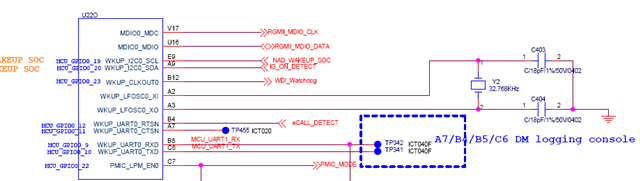

Hi TI,
请问AM6202的内部RTC在深度睡眠时,是否还能继续工作计时,在睡眠一段时间,醒来时能得到一个较精准一点的时间。
WKUP_LFOSC0_XI/XO已有接32.768Khz

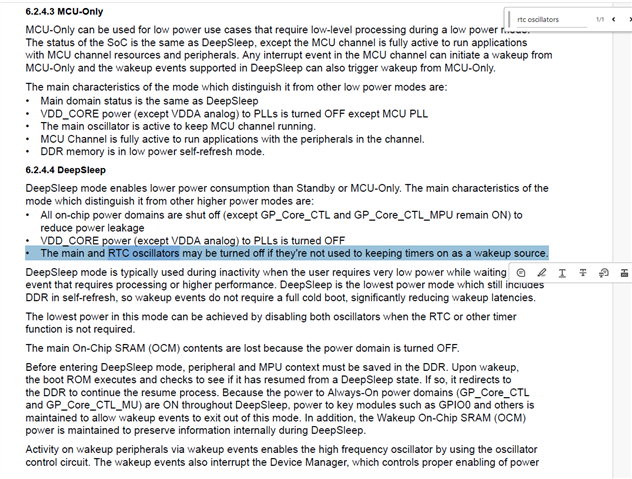

查看文档有说deepsleep模式下,会禁用rtc功能,是否有进deepsleep模式不禁RTC的配置方法?

Upon reviewing the documentation, it is mentioned that in deep sleep mode, the RTC functionality is disabled. Is there a configuration method to enter deep sleep mode without disabling the RTC?
Can you show me where you found this?
The internal RTC is on the WKUP domain on AM62x which doesn't turn off during Deep Sleep.

I found one reference, it tell me rtc could be also go to deep sleep (or turn off?) .
