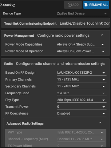

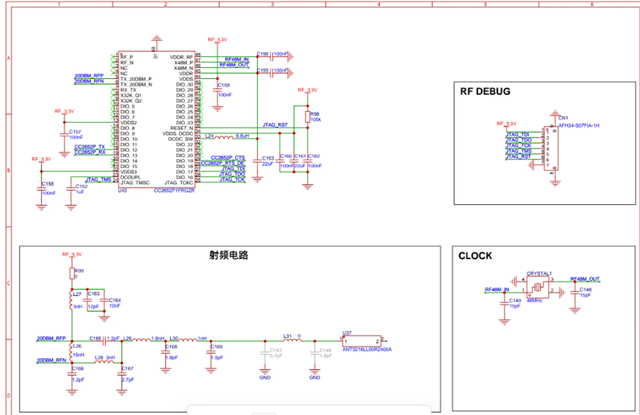

The PCB board designed by myself cannot connect to the Zigbee gateway, but the same embedded code development board can connect
Other Parts Discussed in Thread: CC2652P, SYSCONFIG, CC1352P
Please help me find out if it is an embedded code configuration problem.
  • 1. 使用开发板相同的嵌入式代码,是可以连接网关的。
    2. 自己开发的板子 使用外置天线也没办法连接,天线是好的。
    3. 芯片用的是cc2652P 和网关只有20厘米近,也连不上。

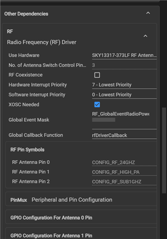

  • This is most likely caused by an incorrect capacitor array delta.
    What is your configuration for that in SysConfig, compared to the one on the default board?
  • Please list your SimpleLink F2 SDK and SysConfig versions.  You can also provide your SysConfig file for easier review.  Nevertheless, I don't see anything concerning with the settings you've provided.  Have you submitted the custom design to SIMPLELINK-2-4GHZ-DESIGN-REVIEWS for review?  Is your crystal and RF path antenna design exactly the same as a TI LaunchPad EVM, or if not then what differences are there?  Have you debugged the device state and call stack, debugged RF output, and used a sniffer log to confirm over-the air packets?  Are you factory resetting or erasing all flash on the device before programming and running the Zigbee firmware?
     * These arguments were used when this file was generated. They will be automatically applied on subsequent loads
     * via the GUI or CLI. Run CLI with '--help' for additional information on how to override these arguments.
     * @cliArgs --board "/ti/boards/CC1352P_2_LAUNCHXL" --device "CC1352P1F3RGZ" --part "Default" --package "RGZ" --rtos "tirtos7" --product "simplelink_cc13xx_cc26xx_sdk@8.31.00.11"
     * @v2CliArgs --board "/ti/boards/CC1352P_2_LAUNCHXL" --device "CC1352P" --package "VQFN (RGZ)" --rtos "tirtos7" --product "simplelink_cc13xx_cc26xx_sdk@8.31.00.11"
     * @versions {"tool":"1.25.0+4268"}

    CCFG.xoscCapArray             = true;
    CCFG.xoscCapArrayDelta        = 0xC1;

    rfdesign.rfDesign = "LAUNCHXL-CC1352P-2";
    rfdesign.fbSub1g  = "none";

    zstack.deviceType                                 = "zed";
    zstack.deviceTypeReadOnly                         = true;
    zstack.touchlink.$name                            = "ti_zstack_touchlink_zstack_touchlink0";
    zstack.pm.$name                                   = "ti_zstack_pm_zstack_pm0";
    zstack.rf.$name                                   = "ti_zstack_rf_zstack_rf0";
    zstack.rf.txPower                                 = "14";
    zstack.rf.primaryChannels                         = [11,15];
    zstack.rf.secondaryChannels                       = [11,15];

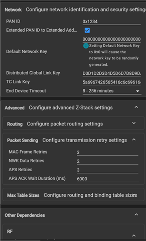

    zstack.network.$name                              = "ti_zstack_network_zstack_network0";
    zstack.network.panID                              = "0x1234";
    zstack.advanced.$name                             = "ti_zstack_advanced_zstack_advanced0";
    zstack.advanced.routing.$name                     = "ti_zstack_advanced_zstack_routing0";
    zstack.advanced.packetSending.$name               = "ti_zstack_advanced_zstack_packet_sending0";
    zstack.advanced.packetSending.apscMaxFrameRetries = 4;
    zstack.advanced.packetSending.nwkDataRetries      = 3;
    zstack.advanced.packetSending.macFrameRetries     = 5;

    1.upload my syscfg

    3. PCB schematic diagram
