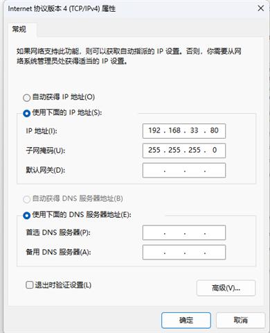

在参考dev.ti.com/.../node mmWave Studio”章节的how to use mmWave Studio to read raw data时,到第五步时,点击"Connect, Reset and Configure"按钮后,output窗口提示“Unable to read FPGA Version. [error -5]“
#主机网络设置:
链接DCA100EVM网卡的IP
防火墙和杀毒软件已关闭,wifi已关闭。

DCA1000EVM:J1通过USB连接主机;J2通过自制电源线连接至实验电源(设置电压5V,电流上限3A);J6通过包装内的网线连接至 a)拓展坞网口 b)电脑内置网口*
IWR6843AOPEVM:J1通过USB连接主机;J11连接至DCA1000EVM。
*:a) b)两种情况都试了,结果一样

[16:51:26] [RadarAPI]: ar1.CaptureCardConfig_EthInit("192.168.33.30", "192.168.33.180", "12:34:56:78:90:12", 4096, 4098)
[16:51:26] [RadarAPI]: ar1.CaptureCardConfig_Mode(1, 2, 1, 2, 3, 30)
[16:51:26] [RadarAPI]: ar1.CaptureCardConfig_PacketDelay(25)
[16:51:26] [RadarAPI]: Sending fpga command to DCA1000
[16:51:36] [RadarAPI]:
[16:51:36] FPGA Configuration :
[16:51:36] Timeout Error! System disconnected
[16:51:36] [RadarAPI]: Sending record command to DCA1000
[16:51:46] [RadarAPI]:
[16:51:46] Configure Record :
[16:51:46] Timeout Error! System disconnected
[16:51:46] [RadarAPI]: ar1.GetCaptureCardFPGAVersion()
[16:51:46] [RadarAPI]: Sending fpga_version command to DCA1000
[16:51:56] [RadarAPI]:
[16:51:56]
[16:51:56] Unable to read FPGA Version. [error -5]
[16:51:56]
我想问下该如何解决这个问题?
