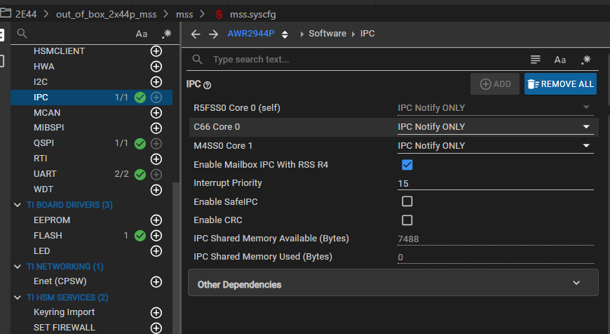

(1)oob例程裁剪
此处ipc修改是否正确?

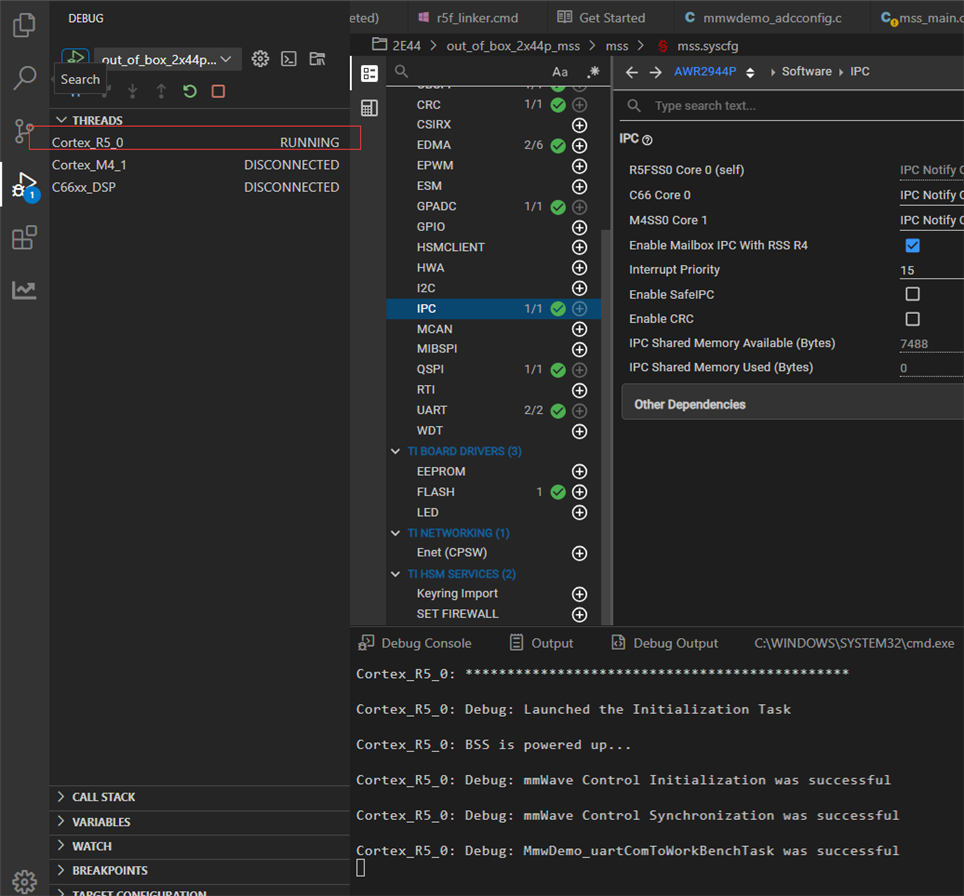

(2)ccsdebug
只连接了R5核并加载mss.xe5f ,串口通信正常。

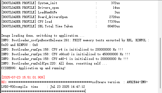

  • [2025-07-23 18:01:54.978]
    RX:
    Starting QSPI Bootloader ...
    INFO: Bootloader_loadSelfCpu:210: CPU r5f0-0 is initialized to 400000000 Hz !!!
    [BOOTLOADER_PROFILE] Boot Media : NOR SPI FLASH
    [BOOTLOADER_PROFILE] Boot Media Clock : 80.000 MHz
    [BOOTLOADER_PROFILE] Boot Image Size : 110 KB
    [BOOTLOADER_PROFILE] Cores present :
    unknown
    c66ss0
    m4ss0-1
    r5f0-0
    [BOOTLOADER PROFILE] System_init : 372us
    [BOOTLOADER PROFILE] Drivers_open : 14us
    [BOOTLOADER PROFILE] LoadHsmRtFw : 3us
    [BOOTLOADER PROFILE] Board_driversOpen : 2726us
    [BOOTLOADER PROFILE] CPU load : 120245us
    [BOOTLOADER_PROFILE] SBL Total Time Taken : 123363us
    Image loading done, switching to application ...
    INFO: Bootloader_socCpuResetRelease:261: PBIST memory tests excucted by RBL, RINFOL : 0x20 and RINFOU : 0x0
    INFO: Bootloader_runCpu:158: CPU r4 is initialized to 200000000 Hz !!!
    INFO: Bootloader_runCpu:158: CPU c66ss0 is initialized to 450000000 Hz !!!
    INFO: Bootloader_runCpu:158: CPU m40-1 is initialized to 200000000 Hz !!!
    INFO: Bootloader_runSelfCpu:220: All done, resetting self ...
    software version : AWR2E44-IMU-LVDS-V00
    compile time : Jul 23 2025 17:57:38

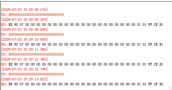

    [2025-07-23 18:02:15.843]
    TX:EB9006000000000000000000000081
    [2025-07-23 18:02:16.933]
    RX:霅?/
    刚验证了保留3个核,m4和c6xx裁剪修改保留进入main随便干点啥事,r5按照之前的裁剪方式,r5对外通信正常,
    麻烦看一下q1的问题,希望只有单个r5也能够正常工作。
