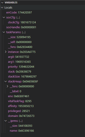

When reaching step 4 of Build the Firmware form Source Code, Execute the Compiled Lab, it seems that the kernel C674X_0 cannot be correctly connected to the.xe674 file under dss. Even so, no error message was output in the Debug Output interface. Instead, the data as shown in the figure was output in the VARIABLES section
I'm quite puzzled because I followed the user's instructions in every step. I searched on forums and other possible places but couldn't solve this problem. I hope to get your answers.Thank you very much.

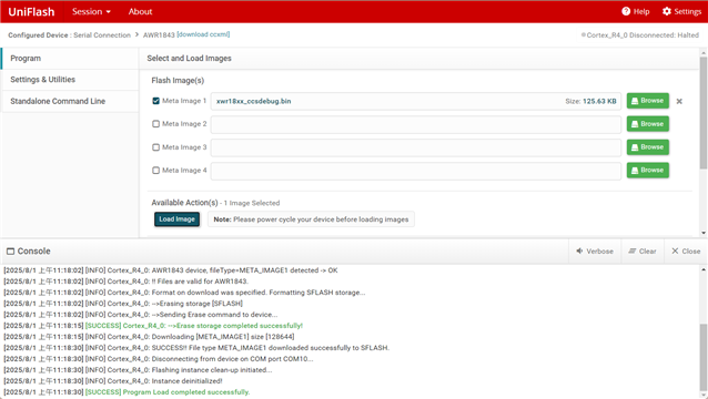

  • Hi
    Pls flash your device with CCSdebug binary, then put the SOP state as 001 (functional mode), then reset and connect cores in CCS.
    Let me know if there are still problems after following above procedure.
    Thanks
    Ken
  • Hi Ken
    Sorry again. It still didn't work.
    I followed your operation. The process screenshot is as follows

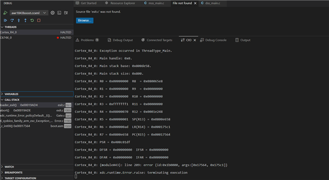

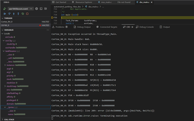

    And I re-imported the official project, performed rebuild again, and generated corresponding files for the two projects. Then, after creating the.ccxml file in the debug interface and connecting it to the kernel Cortex_R4_0, I found the following output (it seemed to have a similar output yesterday, but I didn't notice it)
    Then connect the kernel C674X_0, and the output is as shown in the following figure

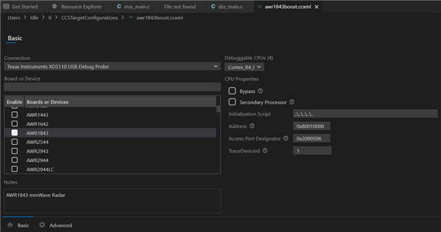

    I have a question at present. Are these errors related to the location of the ccxml file?
    All my projects are placed in the directory [D:\TI\CCS_Project\test_project]
    The location of the added ccxml is in the directory [C:\Users\Idle\ti\CCSTargetConfigurations]
    Here I post the configuration of the ccxml file for your reference
    Looking forward to your reply again. Thank you very much.

    First of all, when I first used these two versions, I never encountered the error message I had before. Later, when I tried to use the latest version of CCS20 again, I found that the previous problem completely disappeared. Although this is a good thing, I don't quite understand why this problem occurred.
    Secondly, when I was using these three versions and re-debugging according to the official user manual, new problems emerged:
    C674X_0: Error: DPM Report 4 received with error:-40112 arg0:0x64 arg1:0x814a3c
    C674X_0: xdc.runtime.Main: ".. /dss_main.c", line 256: assertion failure
    C674X_0: xdc.runtime.Error.raise: terminating execution
    Then I was committed to solving this problem. At first, I didn't find the reason, so I was quite confused. But this afternoon, I suddenly found a post:
    AWR1843AOPEVM: Automated Parking Demo in CCS Debug - 传感器论坛 - 传感器 - E2ETm 设计支持
    He encountered the same problem as me, and then I referred to its solution and reduced the value of numLoops to 64, thus solving the problem.
