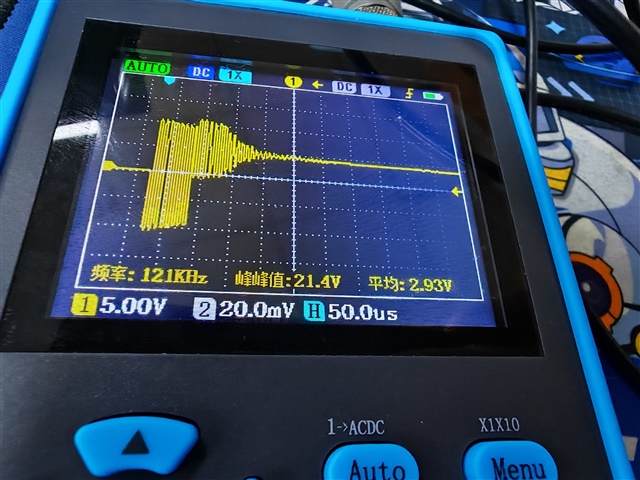

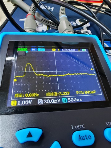

TUSS4470:  TUSS4470: At 120KHz, there is no echo
Part Number: TUSS4470
At 120KHz, there is no echo. How can I test to determine whether it is due to an incompatible transducer or a software issue? The following is the initialization configuration:
tuss4470Write(0x10, 0x14);  // Set BPF center frequency
  tuss4470Write(0x16, 0xF);  // Enable VDRV (not Hi-Z)
  tuss4470Write(0x1A, 0x0f);  // Set burst pulses to 16
  tuss4470Write(0x17, 0x19);
The image is OUTA、OUTB、VOUT
