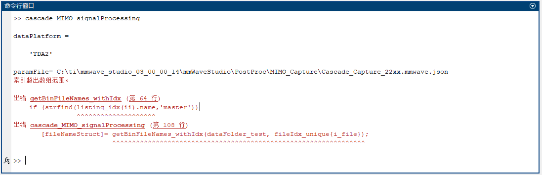

我根据user guide的指导对采集的MIMO数据进行matlab后处理时,到了运行cascade_MIMO_signalProcessing.m时报错如下图:
请问如何解决?

That script in mmWave Studio is for 4-chip cascade capture with TDA2. The Matlab scripts for 2-chip cascade (main_Process_2chipCascadeData.m) seem to be missing in the Radar Toolbox package. Thanks for catching this and sorry for the confusion.
Please find them attached.e2e.ti.com/.../generate_5F00_VirtualArray_5F00_2chipCascade.m
