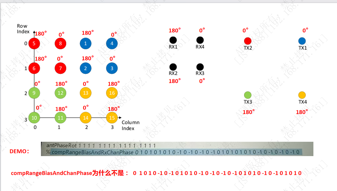

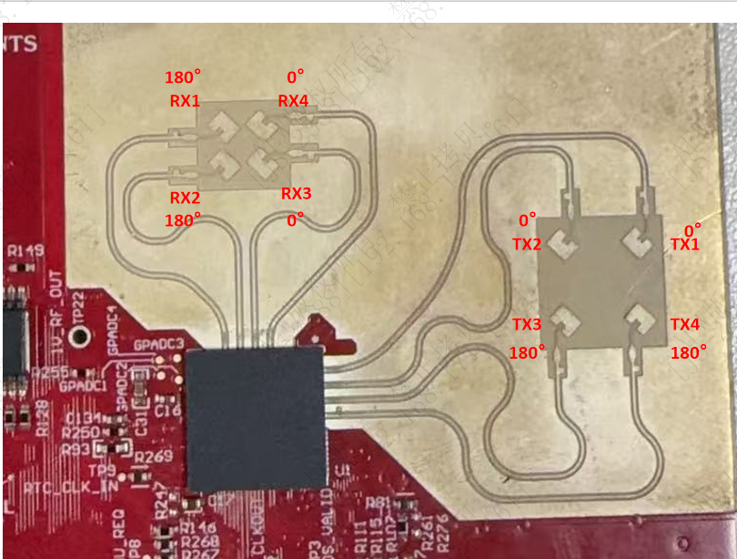

AWRL6844: AWRL6844开发板虚拟阵列相位问题
