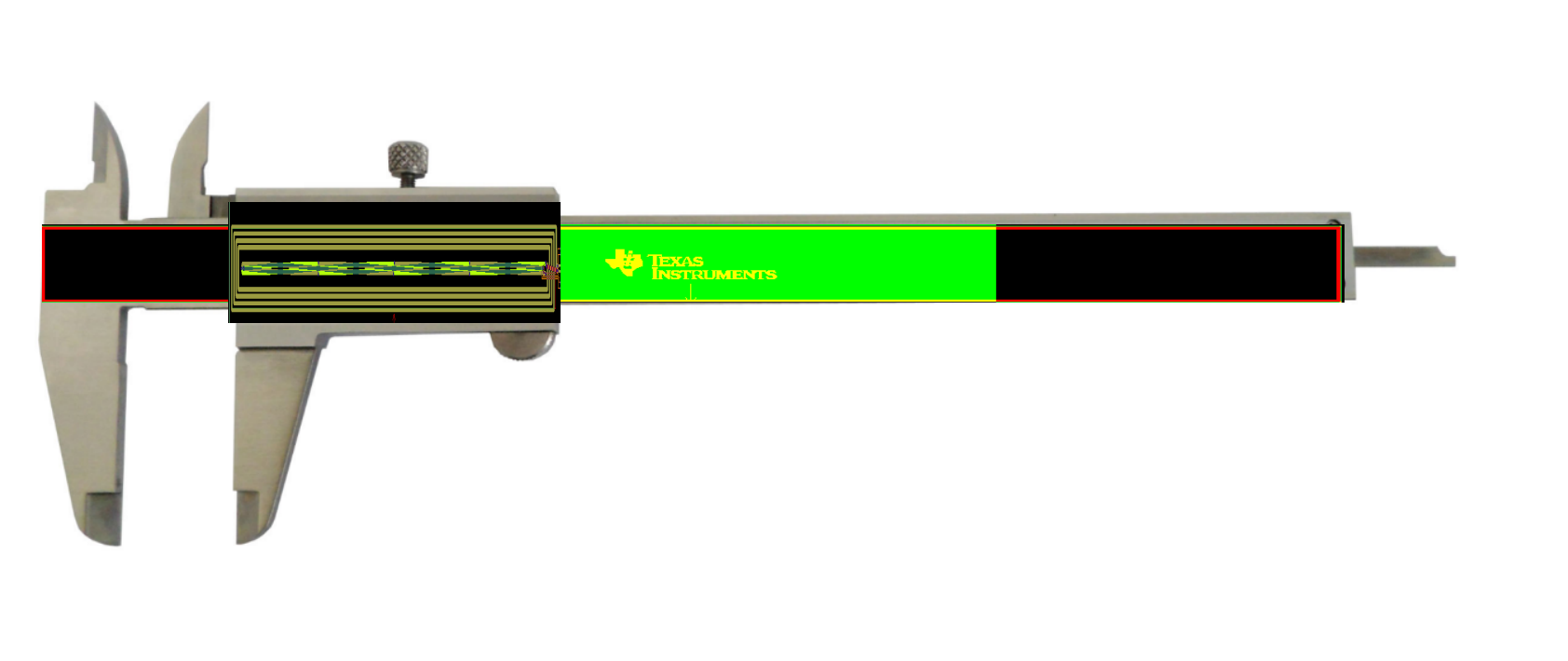

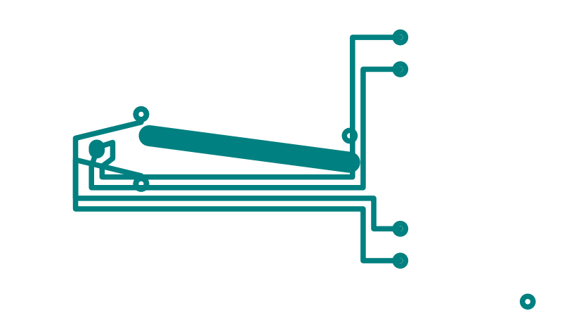

Hello everyone,
Question 1:
I’d like to ask—when I was designing a Type-I coil, I noticed that part of the coil overlaps or crosses over itself. Is this correct? Additionally, I haven’t been able to find an appropriate coil dimension. Could you please help design one for me?
Question 2:
I also want to ask—would it be reasonable to design this inductive caliper using the same scale body and structural layout as my previously designed capacitive grating caliper?
Below are my attachments regarding Question 1 and Question 2.
Our experts on this topic are currently out of office for the holidays. They should be able to respond when they are back on January 5th.
1. No, This is not correct. The traces should not overlap causing shorts. This is likely an error in the design tool.
2. I have not seen other customers desinging calipers using inductive sensing, but it should work with a linear type inductive sensor.
