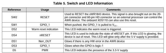

AWR1843boost, the yellow light of is flashing, and the red light is flashing above and below the green light
