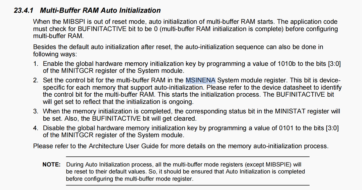

用户手册(IWR14xx/16xx/18xx/68xx/64xx Industrial Radar Family Technical Reference Manual)中描述MibSPI的时候,提到了MINITGCR、MINISTAT和MSINENA寄存器,但我在检索整个文件中,并没有看见其寄存器描述。还有就是,这里提到的“
Please refer to the Architecture User Guide for more details on the memory auto-initialization process.
