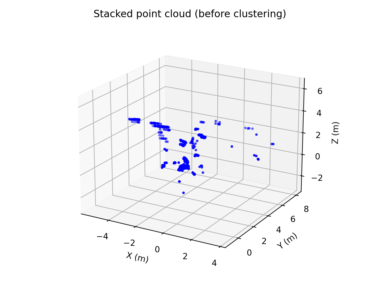

IWR6843AOPEVM: 、使用3d people tracking来采集动作数据时,在代码中添加了静态点,但采集后发现噪声点很多,且动作不清晰,如何使得采集的数据人体簇动作更加清晰?
Part Number: IWR6843AOPEVM
Other Parts Discussed in Thread: AWRL6844, IWR6843, IWR6843AOP
采集到的数据中噪声非常多,人体簇不清晰,动作不清晰,应该如何解决?

  • Hi
    请调整你的射频配置,增加距离分辨率。
    或参考如下链接切换TI最新AWRL6844,更多的发射通道使得整体的点云效果大幅提升。
    6844 People Tracking User Guide
    Thanks
    Ken
  • 我目前使用的是这个参数配置,请问我应该调整哪里?以及调整多少比较合适?
    % SDK Parameters
    % See the SDK user's guide for more information
    % "C:\ti\mmwave_sdk_[VER]\docs\mmwave_sdk_user_guide.pdf"
    sensorStop
    flushCfg
    dfeDataOutputMode 1
    channelCfg 15 7 0
    adcCfg 2 1
    adcbufCfg -1 0 1 1 1
    lowPower 0 0
    % Detection Layer Parameters
    % See the Detection Layer Tuning Guide for more information
    % "<RADAR_TOOLBOX_INSTALL_DIR>\source\ti\examples\People_Tracking\docs\IWR6843_People_Tracking_PDFs\3D_people_tracking_detection_layer_tuning_guide.pdf"
    profileCfg 0 60.75 30.00 25.00 59.10 394758 0 54.71 1 96 2950.00 2 1 36
    chirpCfg 0 0 0 0 0 0 0 1
    chirpCfg 1 1 0 0 0 0 0 2
    chirpCfg 2 2 0 0 0 0 0 4
    frameCfg 0 2 96 0 55.00 1 0
    dynamicRACfarCfg -1 4 4 2 2 8 12 4 12 5.00 8.00 0.40 1 1
    staticRACfarCfg -1 6 2 2 2 8 8 6 4 8.00 12.00 0.30 0 0
    dynamicRangeAngleCfg -1 0.75 0.0010 1 0
    dynamic2DAngleCfg -1 3.0 0.0300 1 0 1 0.30 0.85 8.00
    staticRangeAngleCfg -1 0 8 8
    antGeometry0 -1 -1 0 0 -3 -3 -2 -2 -1 -1 0 0
    antGeometry1 -1 0 -1 0 -3 -2 -3 -2 -3 -2 -3 -2
    antPhaseRot 1 -1 1 -1 1 -1 1 -1 1 -1 1 -1
    fovCfg -1 70.0 70.0
    compRangeBiasAndRxChanPhase 0 1 0 1 0 1 0 1 0 1 0 1 0 1 0 1 0 1 0 1 0 1 0 1 0
    % Tracker Layer Parameters
    % See the Tracking Layer Tuning Guide for more information
    % "C:\ti\radar_toolbox_[VER]\source\ti\examples\People_Tracking\docs\IWR6843_People_Tracking_PDFs\3D_people_tracking_tracker_layer_tuning_guide.pdf"
    staticBoundaryBox -3 3 0.5 7.5 0 3
    boundaryBox -4 4 0 8 0 3
    sensorPosition 2 0 15
    gatingParam 3 2 2 3 4
    stateParam 3 3 12 500 5 6000
    allocationParam 20 100 0.1 20 0.5 20
    maxAcceleration 0.1 0.1 0.1
    trackingCfg 1 2 800 30 46 96 55
    presenceBoundaryBox -3 3 0.5 7.5 0 3
    sensorStart
  • 目前我只能用iwr6843aop来进行实验,请问如何具体调整参数呢?
