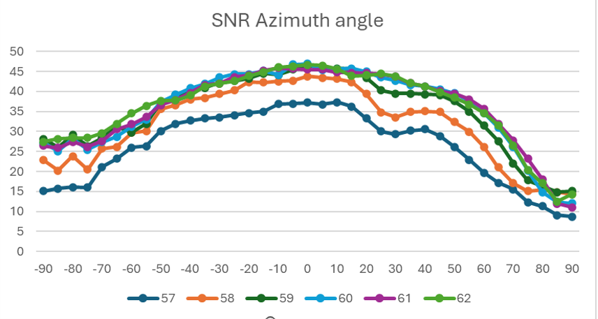

We are currently conducting SNR tests on the IWRL6432BOOST using a corner reflector placed at a distance of 1 meter.
Based on the results, we observed that the SNR at lower frequencies is significantly lower compared to other frequencies. Could you please advise if this is due to software (SW) calibration, or if there might be other factors causing this drop?
The test results are provided below:image.png
