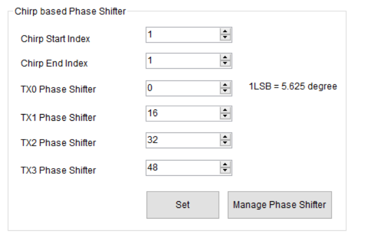

AWR2944EVM: How to configure the AWR2944 to DDMA mode through mmWave Studio, or is there any Lua script available for reference?
Part Number: AWR2944EVM
When I was doing phase configuration in this image, the following issue appeared:
[13:52:25]  [RadarAPI]: ar1.SetPerChirpPhaseShifterConfig(0, 0, 0, 0, 0, 0)
[13:52:25]  Status: Failed, Error Type: API IS ISSUED FOR AN UNSUPPORTED DEVICE
[13:53:11]  [RadarAPI]: ar1.SetPerChirpPhaseShifterConfig(1, 1, 0, 16, 32, 48)
[13:53:11]  Status: Failed, Error Type: API IS ISSUED FOR AN UNSUPPORTED DEVICE
