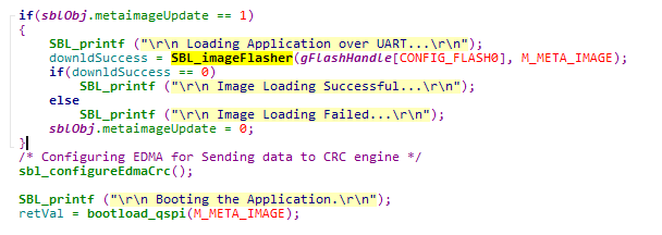

Hi TI.Team:
After burning the sbl program, I started the machine and it entered sbl upgrade Main App mode. My computer transferred the appimage through XMODEM, but after the transfer was complete, I couldn't start the Main App properly,I checked that the address to which sbl is redirected is # define M-META_SMAGE ((uint322-t) M-META_SBL+(uint322-t) (x8000U)),But I don't know how to set the burning address for the Main App,Can you tell me how to set it up?
SDK:MMWAVE_L_SDK_05_05_04_02
DEMO: motion_and_presence_detection
Please assist me in organizing the process to see if it is correct,

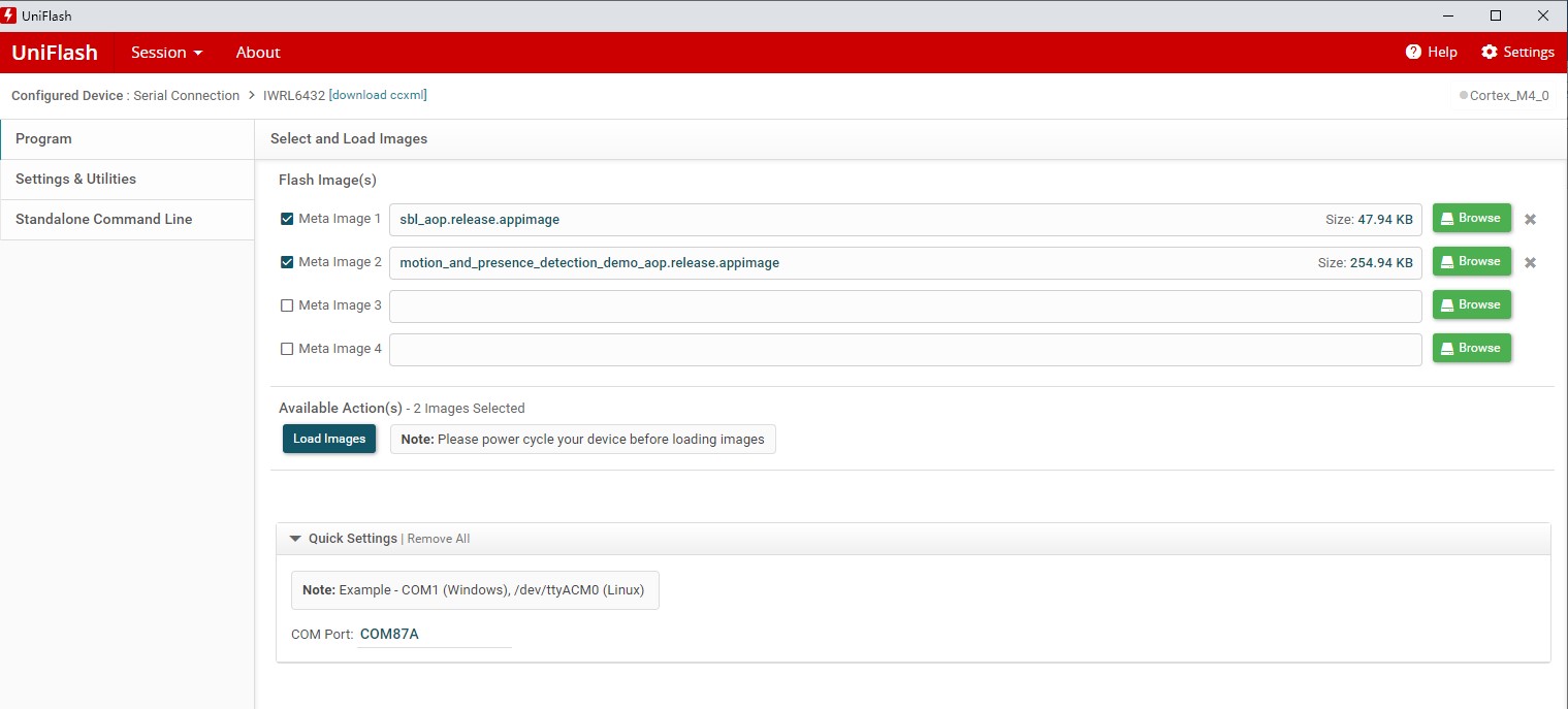

1: Start sbl from address 0 and jump to the Main app startup address if no upgrade is required
2: Main App needs to set startup address offset
3: When burning Uinflash, simply burn the compiled sbl.appimage and main'app.app_image
Thanks
Cole

  • Hello,
        Please refer to EXAMPLES_DRIVERS_SBL.html, there are steps.

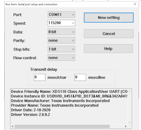

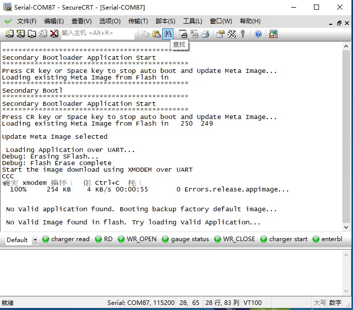

  • Hi Alice:
    Thank you very much for your support,
    Currently, I am upgrading iwrl6432 through UART on CYW55913,
    I see that all data has been transmitted, but the upgrade was unsuccessful. The attachments are my code and logs. Can you help me check if there are any errors there?
    **I followed your SOP and successfully upgraded using the Tera Term computer
    **But if we use SecureCRTPortable, it's the same phenomenon as I encountered
    **I have seen that SBL_imageFlasher has successfully loaded
    This problem has been stuck for a few days, and I really hope to get your help
    Thanks
    Cole

  • Hello,
          Do you mean it update successful via Tera Term but fail via SecureCRTPortable with same iwrl6432 hardware and software ?
          It is unbelievable since they are serial debug tool , maybe you can check the difference between the configure in tool.
  • Hi Alice
    Yes, using different computer software will result in different outcomes. I only see options for configuring 1K or 128, so I can't really check where the problem lies. Have you all sent demonstrations of the data?
    Thanks
    Cole
