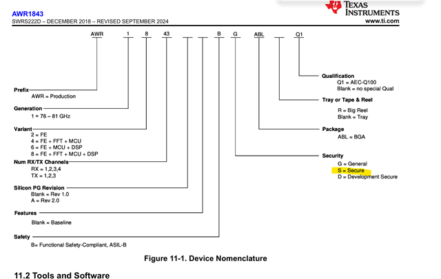

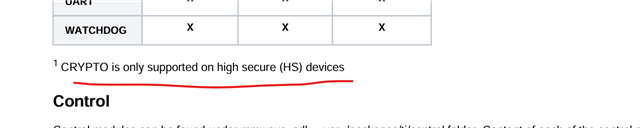

AWR1843BOOST: AWR1843: The call to the Crypto_open() function in the AWR1843 demo project, causes the software to freeze/crash
Part Number: AWR1843BOOST
Chip Model:    AWR1843ABGABLRQ1
Issue Description:    In the MmwDemo_initTask task function of the SDK(mmwave_sdk_03_06_02_00-LTS) demo project, when calling the Crypto_open() function, the software consistently hangs/crashes 100% of the time.
