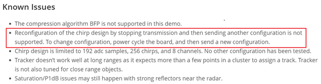

Hello,
I am using the AWR2243-2x-CAS-EVM for my  project. Followed the Two Chip Cascade User Guide to verify the correct operation of the radar, and everything is working properly. I can collect detection data of radar by coding from USB high port after load the cfg file.
But one problem is  need to manual reset the syetem before next sensorstart, I tried sensorstop then restart the sensor then loaded cfg file, it would not send data out. So is there a soft reset cfg or coding to reset the whole system by USB port? or your hardcoded CLI configuration to customize can handle this?
if so could you guide me how the  hardcoded CLI configuration for the AWR2243-2x-CAS-EVM?
