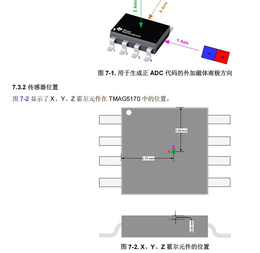

Hello,
Could you please provide the center coordinates of the sensitive axis of the TMAG5170 (refer to the figure below)?
Please confirm:
Are the center coordinates of the X and Y sensitive axes located at the device geometric center?
The Z sensitive axis abscissa is 0.22 mm right of the device center; what is its ordinate?
