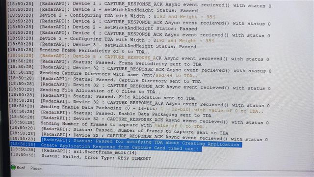

AWR2243: Ti的工程师您好!我按照mmwave studio_cascade_user_guide教程配置AWR2243EVM ES1.0和TDA2XX,我配置256或512个adc采样点能够促发采集到数据,但是当我把adc采样点数改到1024个点时,mmWavestudio报错,如下:
Part Number: AWR2243
 期待您的回答?
  • 在user guide 12. Known Issues and Limitations
    The maximum number of samples per chirp is currently limited to 512 in complex 1x/2x modes, and 1024 in real mode. This is a limitation of the TDA2. There is no workaround at this time.
