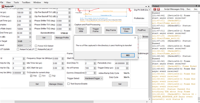

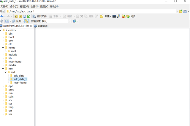

MMWCAS-DSP-EVM: mmwave studio使用
Part Number: MMWCAS-DSP-EVM
TI工程师,你好!
我这里有一套四芯片级联的AWR1243P EVM和DSP EVM,使用mmwave studio软件,在根据mmwave studio casecad user guide.pdf进行操作时,在进行到依次点击从设备触发,最后再点击主设备触发。现象与操作手册中描述的相同。但在点击传输文件到PC上时,却告诉我没有文件,无法传输(如下图),通过WinSCP查看root/mnt/ssd/目录下的捕获数据文件夹也是空的。请问这是怎么回事呢?日志如下:

[21:34:41]  [RadarAPI]: ar1.selectRadarMode(0)
[21:34:41]  [RadarAPI]: Status: Passed
[21:34:41]  Matlab Runtime Engine is installed
[21:34:41]  [RadarAPI]: Starting Matlab Engine..
[21:34:52]  [RadarAPI]: Matlab Engine Started!
[21:34:57]  [RadarAPI]: ar1.selectCascadeMode(0)
[21:34:57]  [RadarAPI]: Status: Passed
[21:34:57]  [RadarAPI]: ar1.LoadSettings('C:\Users\win\AppData\Roaming\RSTD\ar1gui.ini')
[21:34:58]  TESTING = false
[21:34:58]  RstdNet: Port 2777: Listening..
[21:34:58]
[21:34:58]  ***Script completed successfully.***
[21:35:04]  [RadarAPI]: ar1.selectRadarMode(1)
[21:35:04]  [RadarAPI]: ar1.selectCascadeMode(1)
[21:35:04]  [RadarAPI]: Status: Passed
[21:35:06]  [RadarAPI]: ar1.SelectCaptureDevice("TDA2XX")
[21:35:06]  [RadarAPI]: Status: Passed
[21:35:09]  [RadarAPI]: TDAStatusCallback Event Registered
[21:35:09]  [RadarAPI]: registerTDAStatusCallback Status: Passed
[21:35:09]  [RadarAPI]: ar1.ConnectTDA("192.168.33.180", 5001, 15)
[21:35:09]  [RadarAPI]: Device 32 : CAPTURE_RESPONSE_ACK Async event recieved() with status 0
[21:35:09]  [RadarAPI]: Device 32 : CAPTURE_RESPONSE_VERSION_INFO Async event recieved() with status 0. TDA Version : REL_VISION_SDK_03_07_01_00 Aug  5 2019 15:04:45[21:35:09]  [RadarAPI]: Device 32 : CAPTURE_RESPONSE_ACK Async event recieved() with status 0
[21:35:10]  [RadarAPI]: Device 1 : CAPTURE_RESPONSE_ACK Async event recieved() with status 0
[21:35:10]  [RadarAPI]: ConnectTDACaptureCard Status: Passed
[21:35:10]  TDA Capture Card Status : CONNECTED!
[21:35:16]  [RadarAPI]: ar1.SelectChipVersion("AR1243")
[21:35:16]  [RadarAPI]: Status: Passed

[21:38:52]  [RadarAPI]: ar1.DataPathConfig_mult(15, 512, 1216644097, 0)
[21:38:52]  [RadarAPI]: Status: Passed
[21:38:54]  [RadarAPI]: ar1.LvdsClkConfig_mult(15, 1,1)
[21:38:54]  [RadarAPI]: Status: Passed
[21:38:55]  [RadarAPI]: ar1.CSI2LaneConfig_mult(15, 1, 0, 2, 0, 1, 0, 5,0,3,0)
[21:38:56]  [RadarAPI]: Status: Passed
[21:39:08]  [RadarAPI]: ar1.ProfileConfig_mult(1, 0, 77, 100, 6, 60, 0, 0, 0, 0, 0, 0, 29.982, 0, 256, 10000, 0, 0, 30)
[21:39:08]  [RadarAPI]: Status: Passed
[21:39:11]  [RadarAPI]: ar1.ChirpConfig_mult(1, 0, 0, 0, 0, 0, 0, 0, 1, 0,0)
[21:39:11]  [RadarAPI]: Status: Passed
[21:39:15]  [RadarAPI]: ar1.ChirpConfig_mult(1, 1, 1, 0, 0, 0, 0, 0, 0, 1,0)
[21:39:15]  [RadarAPI]: Status: Passed
[21:39:20]  [RadarAPI]: ar1.ChirpConfig_mult(1, 2, 2, 0, 0, 0, 0, 0, 0, 0,1)
[21:39:20]  [RadarAPI]: Status: Passed
[21:39:50]  Test Source Already Disabled...!!!
[21:39:50]  [RadarAPI]: ar1.DisableTestSource_mult(1,0)
[21:39:50]  [RadarAPI]: Status: Passed
[21:39:50]  [RadarAPI]: ar1.FrameConfig_mult(1, 0, 2, 100, 32, 40, 0, 0, 1)
[21:39:54]  [RadarAPI]: ar1.ProfileConfig_mult(2, 0, 77, 100, 6, 60, 0, 0, 0, 0, 0, 0, 29.982, 0, 256, 10000, 0, 0, 30)
[21:39:55]  [RadarAPI]: Status: Passed
[21:39:57]  [RadarAPI]: ar1.ChirpConfig_mult(2, 2, 2, 0, 0, 0, 0, 0, 0, 0,1)
[21:39:57]  [RadarAPI]: Status: Passed
[21:40:01]  [RadarAPI]: ar1.ChirpConfig_mult(2, 1, 1, 0, 0, 0, 0, 0, 0, 1,0)
[21:40:01]  [RadarAPI]: Status: Passed
[21:40:05]  [RadarAPI]: ar1.ChirpConfig_mult(2, 0, 0, 0, 0, 0, 0, 0, 1, 0,0)
[21:40:06]  [RadarAPI]: Status: Passed
[21:40:07]  Test Source Already Disabled...!!!
[21:40:07]  [RadarAPI]: ar1.DisableTestSource_mult(2,0)
[21:40:07]  [RadarAPI]: Status: Passed
[21:40:07]  [RadarAPI]: ar1.FrameConfig_mult(2, 0, 2, 100, 32, 40, 0, 0, 1)
[21:40:10]  Test Source Already Disabled...!!!
[21:40:10]  [RadarAPI]: ar1.DisableTestSource_mult(2,0)
[21:40:10]  [RadarAPI]: Status: Passed
[21:40:10]  [RadarAPI]: ar1.FrameConfig_mult(2, 0, 2, 100, 32, 40, 0, 0, 2)
[21:40:15]  [RadarAPI]: ar1.ProfileConfig_mult(4, 0, 77, 100, 6, 60, 0, 0, 0, 0, 0, 0, 29.982, 0, 256, 10000, 0, 0, 30)

[21:40:28]  [RadarAPI]: ar1.FrameConfig_mult(4, 0, 2, 100, 32, 40, 0, 0, 2)
[21:40:29]  [RadarAPI]: Status: Passed

[21:40:51]  [RadarAPI]: ar1.TDACaptureCard_StartRecord_mult(8, 0, 0, adc_data, 0)
[21:40:51]  Device 0 - Configuring TDA with Width : 2048 and Height : 96
[21:40:51]  [RadarAPI]: Device 0 - setWidthAndHeight Status: Passed
[21:40:51]  [RadarAPI]: Device 1 : CAPTURE_RESPONSE_ACK Async event recieved() with status 0
[21:40:51]  Device 1 - Configuring TDA with Width : 2048 and Height : 96
[21:40:51]  [RadarAPI]: Device 1 - setWidthAndHeight Status: Passed
[21:40:51]  [RadarAPI]: Device 2 : CAPTURE_RESPONSE_ACK Async event recieved() with status 0
[21:40:52]  Device 2 - Configuring TDA with Width : 2048 and Height : 96
[21:40:52]  [RadarAPI]: Device 2 - setWidthAndHeight Status: Passed
[21:40:52]  [RadarAPI]: Device 4 : CAPTURE_RESPONSE_ACK Async event recieved() with status 0
[21:40:52]  Device 3 - Configuring TDA with Width : 2048 and Height : 96
[21:40:52]  [RadarAPI]: Device 3 - setWidthAndHeight Status: Passed
[21:40:52]  [RadarAPI]: Device 8 : CAPTURE_RESPONSE_ACK Async event recieved() with status 0
[21:40:52]  Sending Frame Periodicity of 40 to TDA..
[21:40:52]  [RadarAPI]: Status: Passed. Frame Periodicity sent to TDA
[21:40:52]  [RadarAPI]: Device 32 : CAPTURE_RESPONSE_ACK Async event recieved() with status 0
[21:40:52]  Sending Capture Directory with name /mnt/ssd/adc_data to TDA..
[21:40:52]  [RadarAPI]: Status: Passed. Capture Directory sent to TDA
[21:40:52]  Sending File Allocation of 0 files to TDA..
[21:40:52]  [RadarAPI]: Status: Passed. File Allocation sent to TDA
[21:40:52]  Sending Enable Data Packaging (0 - 16-bit; 1 - 12-bit) with value of 0 to TDA..
[21:40:52]  [RadarAPI]: Status: Passed. Enable Data Packaging sent to TDA
[21:40:52]  Sending Number of frames to capture with value of 0 to TDA..
[21:40:52]  [RadarAPI]: Status: Passed. Number of frames to capture sent to TDA
[21:40:52]  [RadarAPI]: Status: Passed for notifying TDA about Creating Application
[21:40:52]  [RadarAPI]: Status: Passed for notifying TDA about Start Frame
[21:41:18]  [RadarAPI]: ar1.StartFrame_mult(8)
[21:41:18]  [RadarAPI]: Status: Passed
[21:41:18]  [DeviceId-3] Frame start async event received!
[21:42:21]  [RadarAPI]: ar1.StartFrame_mult(4)
[21:42:21]  [RadarAPI]: Status: Passed
[21:42:21]  [DeviceId-2] Frame start async event received!
[21:42:25]  [RadarAPI]: ar1.StartFrame_mult(2)
[21:42:25]  [RadarAPI]: Status: Passed
[21:42:26]  [DeviceId-1] Frame start async event received!
[21:42:38]  [RadarAPI]: ar1.StartFrame_mult(1)
[21:42:38]  [RadarAPI]: Status: Passed
[21:42:38]  [DeviceId-0] Frame start async event received!
[21:42:42]  [RadarAPI]: Frame Ended
[21:42:42]  [DeviceId-0] Frame End async event received!
[21:42:42]  [DeviceId-3] Frame End async event received!
[21:42:42]  [DeviceId-1] Frame End async event received!
[21:42:42]  [DeviceId-2] Frame End async event received!
[21:42:42]  Status: Passed for notifying TDA about Stop Frame
[21:42:42]  [RadarAPI]: Device 32 : CAPTURE_RESPONSE_ACK Async event recieved() with status 0
[21:43:14]  [RadarAPI]: ar1.TDACaptureCard_StartRecord_mult(8, 0, 0, adc_data_1, 0)

[21:43:14]  Sending Capture Directory with name /mnt/ssd/adc_data_1 to TDA..
[21:43:14]  [RadarAPI]: Status: Passed. Capture Directory sent to TDA
[21:43:14]  [RadarAPI]: Device 32 : CAPTURE_RESPONSE_ACK Async event recieved() with status 0

[21:46:28]  [RadarAPI]: ar1.TDACaptureCard_StartRecord_mult(8, 0, 0, adc_data_1, 0)
[21:46:28]  Device 0 - Configuring TDA with Width : 2048 and Height : 96
[21:46:28]  [RadarAPI]: Device 0 - setWidthAndHeight Status: Passed
[21:46:28]  [RadarAPI]: Device 1 : CAPTURE_RESPONSE_ACK Async event recieved() with status 0
[21:46:28]  Device 1 - Configuring TDA with Width : 2048 and Height : 96
[21:46:28]  [RadarAPI]: Device 1 - setWidthAndHeight Status: Passed
[21:46:28]  [RadarAPI]: Device 2 : CAPTURE_RESPONSE_ACK Async event recieved() with status 0
[21:46:28]  Device 2 - Configuring TDA with Width : 2048 and Height : 96
[21:46:28]  [RadarAPI]: Device 2 - setWidthAndHeight Status: Passed
[21:46:28]  [RadarAPI]: Device 4 : CAPTURE_RESPONSE_ACK Async event recieved() with status 0
[21:46:28]  Device 3 - Configuring TDA with Width : 2048 and Height : 96
[21:46:28]  [RadarAPI]: Device 3 - setWidthAndHeight Status: Passed
[21:46:28]  [RadarAPI]: Device 8 : CAPTURE_RESPONSE_ACK Async event recieved() with status 0
[21:46:28]  Sending Frame Periodicity of 40 to TDA..
[21:46:28]  [RadarAPI]: Status: Passed. Frame Periodicity sent to TDA
[21:46:28]  [RadarAPI]: Device 32 : CAPTURE_RESPONSE_ACK Async event recieved() with status 0
[21:46:28]  Sending Capture Directory with name /mnt/ssd/adc_data_1 to TDA..
[21:46:28]  [RadarAPI]: Status: Passed. Capture Directory sent to TDA
[21:46:28]  Sending File Allocation of 0 files to TDA..
[21:46:28]  [RadarAPI]: Status: Passed. File Allocation sent to TDA
[21:46:28]  Sending Enable Data Packaging (0 - 16-bit; 1 - 12-bit) with value of 0 to TDA..
[21:46:28]  [RadarAPI]: Status: Passed. Enable Data Packaging sent to TDA
[21:46:28]  Sending Number of frames to capture with value of 0 to TDA..
[21:46:28]  [RadarAPI]: Status: Passed. Number of frames to capture sent to TDA
[21:46:29]  [RadarAPI]: Status: Passed for notifying TDA about Creating Application
[21:46:29]  [RadarAPI]: Device 32 : CAPTURE_RESPONSE_ACK Async event recieved() with status 0
[21:46:29]  [RadarAPI]: Status: Passed for notifying TDA about Start Frame
[21:46:44]  [RadarAPI]: ar1.StartFrame_mult(8)
[21:46:44]  [RadarAPI]: Status: Passed
[21:46:44]  [DeviceId-3] Frame start async event received!
[21:47:01]  [RadarAPI]: ar1.StartFrame_mult(2)
[21:47:01]  [RadarAPI]: Status: Passed
[21:47:01]  [DeviceId-1] Frame start async event received!
[21:47:19]  [RadarAPI]: ar1.StartFrame_mult(4)
[21:47:19]  [RadarAPI]: Status: Passed
[21:47:19]  [DeviceId-2] Frame start async event received!
[21:48:36]  [RadarAPI]: ar1.StartFrame_mult(1)
[21:48:36]  [RadarAPI]: Status: Passed
[21:48:36]  [DeviceId-0] Frame start async event received!
[21:48:40]  [RadarAPI]: Frame Ended
[21:48:40]  [DeviceId-3] Frame End async event received!
[21:48:40]  [DeviceId-2] Frame End async event received!
[21:48:40]  [DeviceId-0] Frame End async event received!
[21:48:40]  [DeviceId-1] Frame End async event received!
[21:48:40]  Status: Passed for notifying TDA about Stop Frame
[21:48:40]  [RadarAPI]: Device 32 : CAPTURE_RESPONSE_ACK Async event recieved() with status 0
