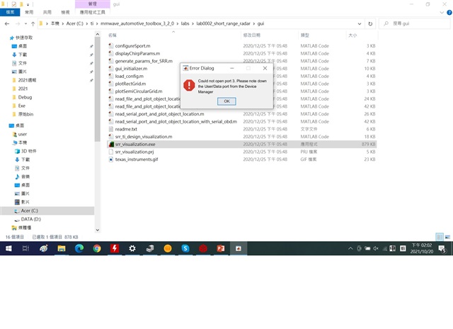

你好:
  我想使用SRR的範例增加GPIO控制,用來顯示燈號
  目前我的作法是在MSS裡的SRR_MSS_initTask增加腳位定義,代碼如下:
  Pinmux_Set_OverrideCtrl(SOC_XWR16XX_PINJ13_PADAC, PINMUX_OUTEN_RETAIN_HW_CTRL, PINMUX_INPEN_RETAIN_HW_CTRL);
  Pinmux_Set_FuncSel(SOC_XWR16XX_PINJ13_PADAC, SOC_XWR16XX_PINJ13_PADAC_GPIO_1);
  Pinmux_Set_OverrideCtrl(SOC_XWR16XX_PINK13_PADAZ, PINMUX_OUTEN_RETAIN_HW_CTRL, PINMUX_INPEN_RETAIN_HW_CTRL);
  Pinmux_Set_FuncSel(SOC_XWR16XX_PINK13_PADAZ, SOC_XWR16XX_PINK13_PADAZ_GPIO_2);
  GPIO_setConfig (SOC_XWR16XX_GPIO_1, GPIO_CFG_OUTPUT);
  GPIO_setConfig (SOC_XWR16XX_GPIO_2, GPIO_CFG_OUTPUT);
static void SRR_MSS_initTask (UArg arg0, UArg arg1)
    int32_t                 errCode;
    MMWave_InitCfg          initCfg;
    UART_Params             uartParams;
    Task_Params             taskParams;
    SOC_SysIntListenerCfg   listenerCfg;
    Semaphore_Params    semParams;
    Mailbox_Config      mboxCfg;
   /* Debug Message: */
    System_printf("Debug: Launched the Initialization Task\n");
     * Initialize the mmWave SDK components:
    /* Pinmux setting */
    /* Setup the PINMUX to bring out the UART-1 */
    Pinmux_Set_OverrideCtrl(SOC_XWR16XX_PINN5_PADBE, PINMUX_OUTEN_RETAIN_HW_CTRL, PINMUX_INPEN_RETAIN_HW_CTRL);
    Pinmux_Set_FuncSel(SOC_XWR16XX_PINN5_PADBE, SOC_XWR16XX_PINN5_PADBE_MSS_UARTA_TX);
    Pinmux_Set_OverrideCtrl(SOC_XWR16XX_PINN4_PADBD, PINMUX_OUTEN_RETAIN_HW_CTRL, PINMUX_INPEN_RETAIN_HW_CTRL);
    Pinmux_Set_FuncSel(SOC_XWR16XX_PINN4_PADBD, SOC_XWR16XX_PINN4_PADBD_MSS_UARTA_RX);
    /* Setup the PINMUX to bring out the UART-3 */
    Pinmux_Set_OverrideCtrl(SOC_XWR16XX_PINF14_PADAJ, PINMUX_OUTEN_RETAIN_HW_CTRL, PINMUX_INPEN_RETAIN_HW_CTRL);
    Pinmux_Set_FuncSel(SOC_XWR16XX_PINF14_PADAJ, SOC_XWR16XX_PINF14_PADAJ_MSS_UARTB_TX);
    /* Setup the PINMUX to bring out the DSS UART */
    Pinmux_Set_OverrideCtrl(SOC_XWR16XX_PINP8_PADBM, PINMUX_OUTEN_RETAIN_HW_CTRL, PINMUX_INPEN_RETAIN_HW_CTRL);
    Pinmux_Set_FuncSel(SOC_XWR16XX_PINP8_PADBM, SOC_XWR16XX_PINP8_PADBM_DSS_UART_TX);
    /*GPIO腳位設定*/
    /* Initialize the UART */
    UART_init();
    /* Initialize the GPIO */
    GPIO_init();
    /* Initialize the Mailbox */
    Mailbox_init(MAILBOX_TYPE_MSS);
    /* Open UART Driver: */

   但當我開UI後會出現錯誤訊息,請問是哪裡出了問題??
