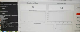

Hi,
I bought some AWR1443 chips, but they don't work on my own PCB. I used 6 pieces of AWR1443 chips, five of which can download code using Uniflash, but the system did not work, as shown in Fig. 1. The download codes is:
C:\ti\mmwave_industrial_toolbox_4_7_0\labs\vital_signs\14xx_vital_signs\pjt\Prebuilt_binaries\xwr14xx_vitalSigns_lab_mss.bin,

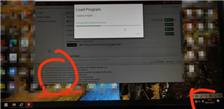

the other chip cannot download the code, as shown in Figure 2.
About a month ago, I also bought some 1443 chips from another company, and they worked fine on the same PCB.
Are there any quality problems with those chips?
Always show this screen AWR1443 is not working                  Fig. 2. The screen that is always displayed when downloading code
 Fig. 1 Always show this screen AWR1443 is not working                  Fig. 2. The screen that is always displayed when downloading code
  • 如果可以的话,做一下交叉实验,看一下是不是芯片本身的问题。
    如果是芯片的问题,从TI授权代理商那里购买的话,请联系您的购买渠道。如果是从TI网上购买的,请提供订单号,需要转给相关部门处理。
