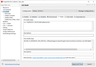

    我现在需要将AWR1642 BOOST的程序移植到AWR1843中,我在《Migrating to xWR68xx and xWR18xx Millimeter Wave Sensors 》中的软件乔迁部分第NO.3中看到需要改变一个bin文件,他的描述如下
      If the application is compiled usingCCS projectspecs, replace xwr16xx_radarss_rprc.binwith xWR18xx_radarss_rprc.bin in the metaimage generation steps (postbuild steps)
Example: For reference CCS projects for xWR1843,see the 18xx – mmWave SDK Demo available in: MMWAVE Industrial Toolbox.
我想请问一下这个操作应该如何来做呢?
