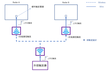

抱歉,我这边没见过这种无线模块。我帮您在e2e sensor论坛上问一下,请关注下面帖子的回复。
https://e2e.ti.com/support/sensors-group/sensors/f/sensors-forum/1056766/awr1642-wireless-module-recommended-for-wireless-synchronization
不客气~
e2e工程师建议用CC3220。
I am not an expert in wireless communication domain, but you could look at using WiFi devices like CC3220 that could be used to sync. The two wifi devices connected to the AWR1642 devices could be synced over air and they could toggle a GPIO to HW trigger the AWr1642 frames.
具体还是建议到无线论坛咨询一下。
https://e2echina.ti.com/support/wireless-connectivity/wifi/f/wi-fi-forum
