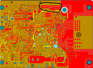

请问板子上这部分是什么作用呢?
请看国外工程师的回复

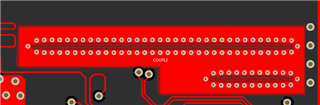

That is a coupon structure for measuring the etching tolerance of the antenna structures for evaluating the manufacturer capabilities.
You can read some more about it in the below app note or if you search 'coupon' on this forum you can find some additional threads about it.
