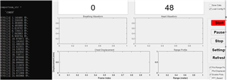

dos一直在计时,demo没有数据输出,串口两个我都调换了试过,也没有输出,还请帮忙看看是哪里设置问题
抱歉,忘了贴user guide链接了。

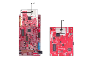

mmWave Sensor Placement
https://dev.ti.com/tirex/explore/node?node=ACqGHSPdQvaQ-h3SNJyqCw__VLyFKFf__LATEST
一直有正确的数据比较奇怪了。

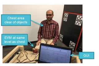

请按照下面的测试做一下,看这种情况下数据能停止吗?
A good test to verify if the sensor is positioned correctly and if accurate measurements are being made is to ask the subject to hold their breath. The breathing-rate should go to zero and turn red, the breathing waveform plot should be more or less constant and the heart rate waveforms should still be visible. If the breathing rate does not go to zero OR the heart rate waveform is not visible then either the subject is not properly aligned with the radar or there is interference coming from other moving objects within the Radar field-of-view.
