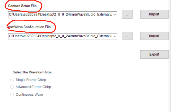

mmwave studio user guide 20.2节中,capture setup JSON operations中导入capture setup file和mmwave configuration file,这两个file有现成的测试用例吗?如果没有的话我应该如何生成这两个file呢?
请参考:
mmwave_studio_02_01_00_00_win32\mmwave_studio_02_01_00_00\mmWaveStudio\JSONSampleFiles
