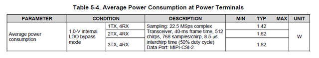

AWR2243的规格书上有整个电源的平均功率,且只有平均值
有没有相关文档可以计算单根天线的最大功率?或者是否有包含相关功率数据的文档?
请看下面e2e工程师的回复。
Are you asking about the change in current during the active chirp period with reduction in the number of TX used? The active current will reduce ~300-350mA on the 1V power rail when you disable 1Tx.
