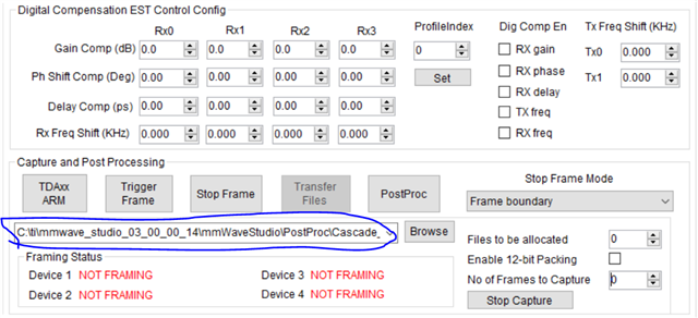

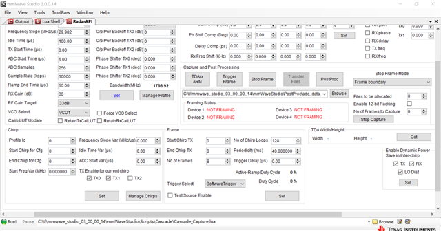

按照User guide中的设置,已经连上了。连接画面如下图
但是在数据采集设置的画面,蓝圈中的内容跟user guide上不一致
先点击“TDAxx ARM”,然后点击Trigger frame,会报如下报文,显示还是not framing
[09:57:32] [RadarAPI]: ar1.TDACaptureCard_StartRecord_mult(1, 0, 0, Cascade_Capture_22xx, 0)
[09:57:32] Device 0 - Configuring TDA with Width : 0 and Height : 0
[09:57:32] [RadarAPI]: Device 0 - setWidthAndHeight Status: Passed
[09:57:32] Device 1 - Configuring TDA with Width : 0 and Height : 0
[09:57:32] [RadarAPI]: Device 1 - setWidthAndHeight Status: Passed
[09:57:32] Device 2 - Configuring TDA with Width : 0 and Height : 0
[09:57:32] [RadarAPI]: Device 2 - setWidthAndHeight Status: Passed
[09:57:32] Device 3 - Configuring TDA with Width : 0 and Height : 0
[09:57:32] [RadarAPI]: Device 3 - setWidthAndHeight Status: Passed
[09:57:32] Sending Frame Periodicity of 0 to TDA..
[09:57:32] [RadarAPI]: Status: Passed. Frame Periodicity sent to TDA
[09:57:35] Frame Periodicity Response from Capture Card timed out!!
[09:57:41] [RadarAPI]: ar1.StartFrame_mult(1)
[09:57:45] Status: Failed, Error Type: RESP TIMEOUT
我在论坛上搜了下相关的帖子,也重新多次设置依然不能解决该问题,还请TI的工程师帮忙看下,谢谢。
  • user guide 里面说明了需要先对slave device点击trigger frame,最后再对master device点击trigger frame,可以试试看
  • 按照楼上Han Deng说的试一下。
    For Frame Configuration, select the “Hardware Trigger” for all the enabled slave devices and “Software Trigger” for Master device.
    [09:57:32] Sending Frame Periodicity of 0 to TDA..这里Frame Periodicity=0有问题
  • 按先对slave device点击trigger frame,在对master device点击trigger frame,试了好几次,还是不行,一直会提示Status: Failed, Error Type: RESP TIMEOUT,还请帮忙看下是什么原因?谢谢。

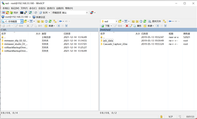

    [13:42:47] Sending Capture Directory with name /mnt/ssd/adc_data to TDA..
    [13:42:47] [RadarAPI]: Status: Passed. Capture Directory sent to TDA
    [13:42:47] [RadarAPI]: Device 32 : CAPTURE_RESPONSE_ACK Async event recieved() with status 0
    [13:42:47] Sending File Allocation of 1 files to TDA..
    [13:42:47] [RadarAPI]: Status: Passed. File Allocation sent to TDA

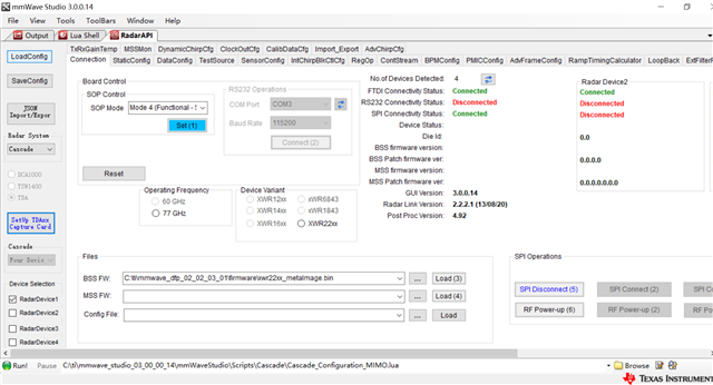

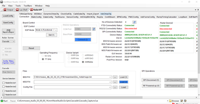

  • 请看一下load BSS firmware的时候,是否使用的是C:\ti\mmwave_dfp\mmwave_dfp_02_02_00_03\firmware\xwr22xx_metaImage.bin,MSS firmware 不用load。从上面的截图,您load的是Mmwave studio里的Firmware,这个是针对boost开发板的。
  • 我加载的就是C:\ti\mmwave_dfp\mmwave_dfp_02_02_00_03\firmware\xwr22xx_metaImage.bin,又重新加载了下,还是同样的报错,如下是截图和打印的数据,还请帮忙再看下,谢谢。

    [16:13:42] [RadarAPI]: ar1.SOPControl_mult(4,4)
    [16:13:42] [RadarAPI]: Status: Passed
    [16:13:44] [DeviceId-2] MSS power up done async event received!
    [16:13:44] [RadarAPI]: ar1.AddDevice(4)
    [16:13:44] [RadarAPI]: Status: Passed
    [16:13:50] [RadarAPI]: ar1.DownloadBSSFw_mult(4,"C:\\ti\\mmwave_dfp_02_02_03_01\\firmware\\xwr22xx_metaImage.bin")
    [16:13:50] [RadarAPI]: ar1.DownloadBssFwOvSPI_mult(4, C:\\ti\\mmwave_dfp_02_02_03_01\\firmware\\xwr22xx_metaImage.bin)
    [16:13:55] [RadarAPI]: ar1.SelectChipVersion("AR1243")
    [16:13:55] [RadarAPI]: Status: Passed
    [16:13:55] [RadarAPI]: ar1.SelectChipVersion("XWR2243")
    [16:13:56] Slave2 Device Status : XWR2243/ASIL-B/SOP:4/ES:1.1
    [16:13:56] [RadarAPI]: ar1.RfEnable_mult(4)
    [16:13:56] [DeviceId-2] BSS power up done async event received!
    [16:13:56] [RadarAPI]: Status: Passed
    [16:14:01] [RadarAPI]: Device 8 : CAPTURE_RESPONSE_ACK Async event recieved() with status 0
    [16:14:02] [RadarAPI]: ar1.FullReset(8)
    [16:14:02] [RadarAPI]: Status: Passed
    [16:14:02] [RadarAPI]: ar1.SOPControl_mult(8,4)
    [16:14:04] [DeviceId-3] MSS power up done async event received!
    [16:14:04] [RadarAPI]: ar1.AddDevice(8)
    [16:14:04] [RadarAPI]: Status: Passed
    [16:14:07] [RadarAPI]: ar1.DownloadBSSFw_mult(8,"C:\\ti\\mmwave_dfp_02_02_03_01\\firmware\\xwr22xx_metaImage.bin")
    [16:14:07] [RadarAPI]: ar1.DownloadBssFwOvSPI_mult(8, C:\\ti\\mmwave_dfp_02_02_03_01\\firmware\\xwr22xx_metaImage.bin)
    [16:14:12] [RadarAPI]: ar1.SelectChipVersion("AR1243")
    [16:14:12] [RadarAPI]: Status: Passed
    [16:14:12] [RadarAPI]: ar1.SelectChipVersion("XWR2243")
    [16:14:12] Slave3 Device Status : XWR2243/ASIL-B/SOP:4/ES:1.1
    [16:14:12] [RadarAPI]: ar1.RfEnable_mult(8)
    [16:14:13] [DeviceId-3] BSS power up done async event received!
    [16:14:13] [RadarAPI]: Status: Passed
    [16:15:27] [RadarAPI]: ar1.TDACaptureCard_StartRecord_mult(2, 0, 0, adc_data, 0)
    [16:15:27] Device 0 - Configuring TDA with Width : 0 and Height : 0
    [16:15:27] [RadarAPI]: Device 0 - setWidthAndHeight Status: Passed
    [16:15:27] [RadarAPI]: Device 1 : CAPTURE_RESPONSE_ACK Async event recieved() with status 0
    [16:15:27] Device 1 - Configuring TDA with Width : 0 and Height : 0
    [16:15:27] [RadarAPI]: Device 1 - setWidthAndHeight Status: Passed
    [16:15:27] [RadarAPI]: Device 2 : CAPTURE_RESPONSE_ACK Async event recieved() with status 0
    [16:15:27] Device 2 - Configuring TDA with Width : 0 and Height : 0
    [16:15:27] [RadarAPI]: Device 2 - setWidthAndHeight Status: Passed
    [16:15:27] [RadarAPI]: Device 4 : CAPTURE_RESPONSE_ACK Async event recieved() with status 0
    [16:15:27] Device 3 - Configuring TDA with Width : 0 and Height : 0
    [16:15:27] [RadarAPI]: Device 3 - setWidthAndHeight Status: Passed
    [16:15:27] [RadarAPI]: Device 8 : CAPTURE_RESPONSE_ACK Async event recieved() with status 0
    [16:15:27] Sending Frame Periodicity of 0 to TDA..
    [16:15:27] [RadarAPI]: Status: Passed. Frame Periodicity sent to TDA
    [16:15:27] [RadarAPI]: Device 32 : CAPTURE_RESPONSE_ACK Async event recieved() with status 0
    [16:15:27] Sending Capture Directory with name /mnt/ssd/adc_data to TDA..
    [16:15:27] [RadarAPI]: Status: Passed. Capture Directory sent to TDA
    [16:15:27] Sending File Allocation of 0 files to TDA..
    [16:15:27] [RadarAPI]: Status: Passed. File Allocation sent to TDA
    [16:15:27] Sending Enable Data Packaging (0 - 16-bit; 1 - 12-bit) with value of 0 to TDA..
    [16:15:27] [RadarAPI]: Status: Passed. Enable Data Packaging sent to TDA
    [16:15:27] Sending Number of frames to capture with value of 0 to TDA..
    [16:15:27] [RadarAPI]: Status: Passed. Number of frames to capture sent to TDA
    [16:15:27] [RadarAPI]: Status: Passed for notifying TDA about Creating Application
    [16:15:35] [RadarAPI]: ar1.StartFrame_mult(2)
    [16:15:37] Create Application Response from Capture Card timed out!!
    [16:15:39] Status: Failed, Error Type: RESP TIMEOUT
    [16:15:49] [RadarAPI]: ar1.StartFrame_mult(4)
    [16:15:53] Status: Failed, Error Type: RESP TIMEOUT
    [16:15:57] [RadarAPI]: ar1.StartFrame_mult(8)
    [16:16:01] Status: Failed, Error Type: RESP TIMEOUT
    [16:16:05] [RadarAPI]: ar1.StartFrame_mult(1)
    [16:16:09] Status: Failed, Error Type: RESP TIMEOUT
  • 方式1、按user guide中我先连接SPI,然后配置MIMO
    配置后会报TDA ARM Failed,而且四个设备的SPI也显示disconnected

    [14:06:40] [RadarAPI]: Error: Could not find file 'C:\ti\mmwave_dfp_02_02_02_01\firmware\xwr22xx_metaImage.bin'
    [14:06:40] Master : FW Download Failed
    [14:06:40]
    [14:06:40] ***Script completed successfully.***

    [15:07:20] [RadarAPI]: Error: Could not find file 'C:\ti\mmwave_dfp_02_02_02_01\firmware\xwr22xx_metaImage.bin'
    [15:07:20] Master : FW Download Failed
    [15:07:20]
    [15:07:20] ***Script completed successfully.***
    [15:07:29] Loops Remaining : 1
    [15:07:29] Starting TDA ARM...
    [15:07:29] [RadarAPI]: ar1.TDACaptureCard_StartRecord_mult(1, 0, 0, Cascade_Capture_22xx, 0)
    [15:07:29] Device 0 - Configuring TDA with Width : 0 and Height : 0
    [15:07:29] [RadarAPI]: Device 0 - setWidthAndHeight Status: Passed
    [15:07:29] [RadarAPI]: Device 1 : CAPTURE_RESPONSE_ACK Async event recieved() with status 0
    [15:07:29] Device 1 - Configuring TDA with Width : 0 and Height : 0
    [15:07:29] [RadarAPI]: Device 1 - setWidthAndHeight Status: Passed
    [15:07:29] [RadarAPI]: Device 2 : CAPTURE_RESPONSE_ACK Async event recieved() with status 0
    [15:07:29] Device 2 - Configuring TDA with Width : 0 and Height : 0
    [15:07:29] [RadarAPI]: Device 2 - setWidthAndHeight Status: Passed
    [15:07:29] [RadarAPI]: Device 4 : CAPTURE_RESPONSE_ACK Async event recieved() with status 0
    [15:07:29] Device 3 - Configuring TDA with Width : 0 and Height : 0
    [15:07:29] [RadarAPI]: Device 3 - setWidthAndHeight Status: Passed
    [15:07:29] [RadarAPI]: Device 8 : CAPTURE_RESPONSE_ACK Async event recieved() with status 0
    [15:07:29] Sending Frame Periodicity of 0 to TDA..
    [15:07:29] [RadarAPI]: Status: Passed. Frame Periodicity sent to TDA
    [15:07:29] [RadarAPI]: Device 32 : CAPTURE_RESPONSE_ACK Async event recieved() with status 0
    [15:07:29] Sending Capture Directory with name /mnt/ssd/Cascade_Capture_22xx to TDA..
    [15:07:29] [RadarAPI]: Status: Passed. Capture Directory sent to TDA
    [15:07:29] Sending File Allocation of 0 files to TDA..
    [15:07:29] [RadarAPI]: Status: Passed. File Allocation sent to TDA
    [15:07:29] Sending Enable Data Packaging (0 - 16-bit; 1 - 12-bit) with value of 0 to TDA..
    [15:07:29] [RadarAPI]: Status: Passed. Enable Data Packaging sent to TDA
    [15:07:29] Sending Number of frames to capture with value of 0 to TDA..
    [15:07:29] [RadarAPI]: Status: Passed. Number of frames to capture sent to TDA
    [15:07:29] [RadarAPI]: Status: Passed for notifying TDA about Creating Application
    [15:07:39] Create Application Response from Capture Card timed out!!
    [15:07:39] TDA ARM Failed
    [15:07:39]
    [15:07:39] ***Script completed successfully.***

  • 请问运行.lua的配置界面是怎么样的?
    另外,AWR2243 ES是什么版本?不同的ES版本使用对应的DFP firmware。
  • AWR2243 ES 版本是1.1
    DFP的firmware我选的是文件加mmwave_dfp_02_02_03_01里面的,DFP官网上应用于2243的只看到这一版
    运行完MIMO.lun的配置界面和再运行caoture.lun后的界面都是下图
    打印的信息在运行完MIMO.lua后提示
    [10:44:30] Master : FW Download Failed
    [10:44:30]
    [10:44:30] ***Script completed successfully.***
    运行完capture.lua后就会提示
    [10:46:35] TDA ARM Failed
    [10:46:35]
    [10:46:35] ***Script completed successfully.***
    完整的打印信息如下

    [10:46:25] Starting TDA ARM...
    [10:46:25] [RadarAPI]: ar1.TDACaptureCard_StartRecord_mult(1, 0, 0, Cascade_Capture_22xx, 0)
    [10:46:25] Device 0 - Configuring TDA with Width : 0 and Height : 0
    [10:46:25] [RadarAPI]: Device 0 - setWidthAndHeight Status: Passed
    [10:46:25] Device 1 - Configuring TDA with Width : 0 and Height : 0
    [10:46:25] [RadarAPI]: Device 1 : CAPTURE_RESPONSE_ACK Async event recieved() with status 0
    [10:46:25] [RadarAPI]: Device 1 - setWidthAndHeight Status: Passed
    [10:46:25] [RadarAPI]: Device 2 : CAPTURE_RESPONSE_ACK Async event recieved() with status 0
    [10:46:25] Device 2 - Configuring TDA with Width : 0 and Height : 0
    [10:46:25] [RadarAPI]: Device 2 - setWidthAndHeight Status: Passed
    [10:46:25] [RadarAPI]: Device 4 : CAPTURE_RESPONSE_ACK Async event recieved() with status 0
    [10:46:25] Device 3 - Configuring TDA with Width : 0 and Height : 0
    [10:46:25] [RadarAPI]: Device 3 - setWidthAndHeight Status: Passed
    [10:46:25] [RadarAPI]: Device 8 : CAPTURE_RESPONSE_ACK Async event recieved() with status 0
    [10:46:25] Sending Frame Periodicity of 0 to TDA..
    [10:46:25] [RadarAPI]: Status: Passed. Frame Periodicity sent to TDA
    [10:46:25] [RadarAPI]: Device 32 : CAPTURE_RESPONSE_ACK Async event recieved() with status 0
    [10:46:25] Sending Capture Directory with name /mnt/ssd/Cascade_Capture_22xx to TDA..
    [10:46:25] [RadarAPI]: Status: Passed. Capture Directory sent to TDA
    [10:46:25] Sending File Allocation of 0 files to TDA..
    [10:46:25] [RadarAPI]: Status: Passed. File Allocation sent to TDA
    [10:46:25] Sending Enable Data Packaging (0 - 16-bit; 1 - 12-bit) with value of 0 to TDA..
    [10:46:25] [RadarAPI]: Status: Passed. Enable Data Packaging sent to TDA
    [10:46:25] Sending Number of frames to capture with value of 0 to TDA..
    [10:46:25] [RadarAPI]: Status: Passed. Number of frames to capture sent to TDA
    [10:46:25] [RadarAPI]: Status: Passed for notifying TDA about Creating Application
    [10:46:35] Create Application Response from Capture Card timed out!!
    [10:46:35]
    [10:47:07] [RadarAPI]: ar1.SelectCaptureDevice("TDA2XX")
    [10:47:07] [RadarAPI]: Status: Passed
  • Error: Could not find file 'C:\ti\mmwave_dfp_02_02_02_01\firmware\xwr22xx_metaImage.bin'
    请在LUA脚本里修改正确的firmware地址。

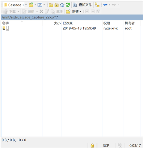

  • 你好,我修改了脚本以后,先运行MIMO脚本,然后再运行capture脚本,同时也打开了WinSCP,但是提示连接超时
    这种状态说说明数据已经捕捉到了,只是无法通过以太网发给PC吗?
    [14:17:20] Starting Transfer files using WinSCP..
    [14:17:42] [RadarAPI]: Error: Network error: Connection to "192.168.33.180" timed out.
    [14:17:42] Transferring files FAILED!
    如下是完整的打印信息

    [14:17:14] Sending Capture Directory with name /mnt/ssd/Cascade_Capture_22xx to TDA..

    WinSCP截图
    另外sensorconfig界面已经显示Framing
  • 你好,
    在winSCP里是否已经可以看到采集的数据?
    请问你的电脑上是否有杀毒软件、防火墙导致网络的问题?能否关闭后尝试。
  • 你好,winSCP里面显示是空的,我把杀毒软件、防火墙都关了,问题变成了如下的状态,而且在运行cascade capture.lun时,以太网端口的指示灯会灭掉,脚本运行完才亮,是以太网没通吗?Demo板如何判断以太网通没通?谢谢。
