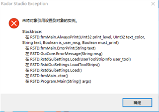

默认安装后显示
C盘无AppData文件夹
请看一下matlab和visual C++是否安装了?
2. Install 32-bit Matlab Runtime Engine (Version 8.5.1): It is used to run the PostProcessing utility within mmWaveStudio. in.mathworks.com/.../R2015 aSP1/installers/win32/MCR_R2015aSP1_win32_installer.exe
4. Install Microsoft Visual C++ 2013 Redistributable package if using a Windows 10 machine from the link https://support.microsoft.com/en-us/help/3179560
https://software-dl.ti.com/ra-processors/esd/MMWAVE-STUDIO/latest/exports/mmwave_studio_user_guide.pdf
