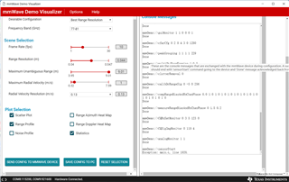

求助,我在使用AWR1443BOOST时候遇到了两个问题;
1.我通过UniFlash软件对AWR1443BOOST进行烧录,烧录的文件来源为 XX\mmwave_sdk_02_01_00_04\packages\ti\demo\xwr14xx\mmw\xwr14xx_mmw_demo.bin;
   用mmWave Demo Visualizer 2.1.0 连接上开发板后,发送config命令,但是发生报错,该如何解决?
mmwDemo:/>% Created for SDK ver:02.01
Skipped
mmwDemo:/>% Created using Visualizer ver:2.1.0.3
Skipped
mmwDemo:/>% Frequency:77
Skipped
mmwDemo:/>% Platform:xWR14xx
Skipped
mmwDemo:/>% Scene Classifier:best_range_res
Skipped
mmwDemo:/>% Azimuth Resolution(deg):15
Skipped
mmwDemo:/>% Range Resolution(m):0.044
Skipped
mmwDemo:/>% Maximum unambiguous Range(m):9.01
Skipped
mmwDemo:/>% Maximum Radial Velocity(m/s):1
Skipped
mmwDemo:/>% Radial velocity resolution(m/s):0.13
Skipped
mmwDemo:/>% Frame Duration(msec):100
Skipped
mmwDemo:/>% Range Detection Threshold (dB):15
Skipped
mmwDemo:/>% Range Peak Grouping:enabled
Skipped
mmwDemo:/>% Doppler Peak Grouping:enabled
Skipped
mmwDemo:/>% Static clutter removal:disabled
Skipped
mmwDemo:/>% ***************************************************************
Skipped
mmwDemo:/>sensorStop
Done
mmwDemo:/>flushCfg
Done
mmwDemo:/>dfeDataOutputMode 1
Done
mmwDemo:/>channelCfg 15 5 0
Done
mmwDemo:/>adcCfg 2 1
Done
mmwDemo:/>adcbufCfg 0 1 0 1
Done
mmwDemo:/>profileCfg 0 77 429 7 57.14 0 0 70 1 240 4884 0 0 30
Done
mmwDemo:/>chirpCfg 0 0 0 0 0 0 0 1
Done
mmwDemo:/>chirpCfg 1 1 0 0 0 0 0 4
Done
mmwDemo:/>frameCfg 0 1 16 0 100 1 0
Done
mmwDemo:/>lowPower 0 1
Done
mmwDemo:/>guiMonitor 1 1 0 0 0 1
Done
mmwDemo:/>cfarCfg 0 2 8 4 3 0 1280
Done
mmwDemo:/>peakGrouping 1 1 1 1 229
Done
mmwDemo:/>multiObjBeamForming 1 0.5
Done
mmwDemo:/>clutterRemoval 0
Done
mmwDemo:/>calibDcRangeSig 0 -5 8 256
Done
mmwDemo:/>compRangeBiasAndRxChanPhase 0.0 1 0 1 0 1 0 1 0 1 0 1 0 1 0 1 0 1 0 1 0 1 0 1 0
Done
mmwDemo:/>measureRangeBiasAndRxChanPhase 0 1.5 0.2
Done
mmwDemo:/>CQRxSatMonitor 0 3 5 123 0
Done
mmwDemo:/>CQSigImgMonitor 0 119 4
Done
mmwDemo:/>analogMonitor 1 1
Done
mmwDemo:/>sensorStart
Exception: main.c, line 1920.

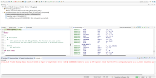

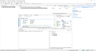

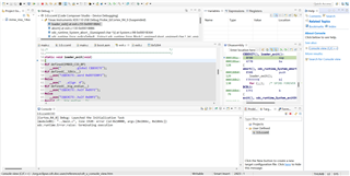

2.我尝试根据教程,采用debug mode进行调试;通过UniFlash软件对AWR1443BOOST进行烧录,烧录的文件来源为 XX\mmwave_sdk_02_01_00_04\packages\ti\utils\ccsdebug\xwr14xx_ccsdebug.bin
   用CCS 8.1.0 进行调试时候报错;
其中console描述为:
 Cortex_R4_0: Trouble Reading Memory Block at 0x3e4a on Page 0 of Length 0x70:(Error -1208 @ 0x20000600) Unable to access an ETM register. Check that the ETM is configured properly as a cs_child. (Emulation package 8.0.27.9)
