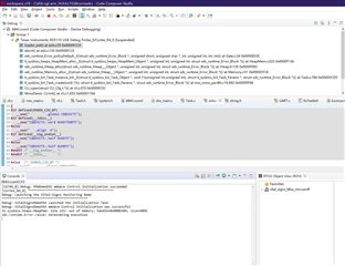

您好,我在按照这篇博客[FAQ] IWR6843: How to add a hard coded configuration to mmWave radar projects - Sensors forum - Sensors - TI E2E support forums进行hard coded configuration,但是我将程序加载进6843执行,发现在创建CLI_task时出现错误,程序终止:
ti.sysbios.heaps.HeapMem: line 221: out of memory: handle=0x800b384, size=4096
xdc.runtime.Error.raise: terminating execution
