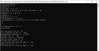

IWR6843ISK: 我把vital_signs_demo_68xx.bin烧写进isk,然后搭配boost板去进行生命体征检测演示,gui没反应
Part Number: IWR6843ISK
Other Parts Discussed in Thread: IWR6843, MMWAVEICBOOST
QT version = 5.9.1
QMetaObject::connectSlotsByName: No matching signal for on_buttonBox_accepted()
Serial Port Found
Data Port Number is "COM6"
User Port Number is "COM15"
Data port succesfully Open
User port succesfully Open
Configuration File Name Read from the GUI is %s/n "xwr1642_profile_VitalSigns_20fps_Back.cfg"
"COM15"
Configuration File Path is %s/n "C:/ti/mmwave_industrial_toolbox_4_9_0/labs/vital_signs/68xx_vital_signs/gui/profiles/xwr1642_profile_VitalSigns_20fps_Front.cfg"
"sensorStop"
"flushCfg"
"dfeDataOutputMode 1"
"channelCfg 15 3 0"
"adcCfg 2 1"
"adcbufCfg -1 0 0 1 0"
"profileCfg 0 60.25 7 6 57 0 0 65 1 200 4000 0 0 40"
"chirpCfg 0 0 0 0 0 0 0 1"
"frameCfg 0 0 2 0 50 1 0"
"lowPower 0 1"
"guiMonitor 0 0 0 0 1"
"calibDcRangeSig -1 0 0 0 0"
"vitalSignsCfg 0.3 0.9 256 512 4 0.1 0.05 100000 300000"
"motionDetection 1 20 2.0 0"
"sensorStart"
"sensorStop"
"flushCfg"
"channelCfg 15 3 0"
"adcCfg 2 1"
"lowPower 0 1"
0.3
0.9
4
"sensorStart"
Chirp Duration in us is : 50
Chirp Bandwidth in kHz is : 3250
Maximum Range in Meters is : 9.23077
Range-FFT size is : 256
Range-Bin size is : 0.0360577
Range-Bin Start Index is : 8
Range-Bin End Index is : 24
Total Payload size from the UART is : 252
Padding Factor is : 8
Total Payload size from the UART is : 256
我想问下是不是我操作有问题,之前资源中心iwr6843的指导的,现在查看没有了
