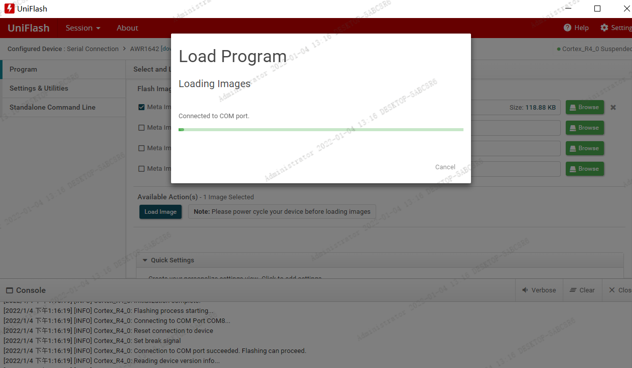

如下图所示,我们的产品在使用AWR1642 SOC开发,使用Uniflash 6.3.0.3193工具烧录bin文件时串口打开进度一直卡住,但是用其他同事的电脑Uniflash工具能正常烧录,请问是什么原因?
是的,电流要求大于2.5A,在boost文档里有要求。
NOTE: A 5-V, > 2.5-A supply brick with a 2.1-mm barrel jack (center positive) is not included. TI
recommends using an external power supply that complies with applicable regional safety
standards, such as UL, CSA, VDE, CCC, PSE, and more. The length of the power cable
should be < 3 m.
https://www.ti.com/lit/ug/swru508c/swru508c.pdf
