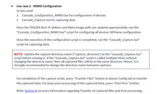

1.
change the directory name between captures,这是什么意思呢,每次load " ***. lua "文件,需要更改目录?怎么更改,不是很明白。

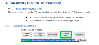

2. 8. Transferring Files and Post-Processing
不知capture and Post Processing窗口是在哪出现或者调出来的呢?

1. 设置不同的路径可以区分不同时候抓取的数据,可以看一下下面的详细说明。
capture_directory: is the filename under which captures are stored on the SSD and is also the directory to which files will be transferred back to the host
The captures are copied to the PostProc folder within mmWave Studio
Note: If this script is called multiple times without changing the directory name, then all captured files will be in the same directory with filename suffixes incremented automatically. It may be hard to know which captured files correspond to which run of the script.
Note: It is strongly recommended to change this directory name between captures.
2. 点击postproc按钮后会自动弹出。
