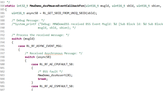

我想问一下,这个回调函数的作用是什么?
处理来自BSS的事件。
Registered event callback function on DSS which is invoked by MMWAVE library when an event from the BSS is received.
