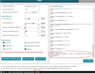

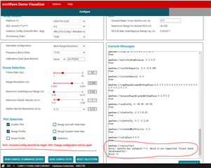

当前AWR2243 Boost+AM2732EVM硬件在下载完am273x_mmw_demoTDM.appimage(SDK4.2.0.2),参考mmwave_mcuplus_sdk_user_guide.pdf,在mmWave_Demo_Visualizer-4.2.0中参数配置时会显示配置错误,如下,mmwDemo:/>sensorStart Error: openCfg has iqSwapSel = 0, which is not supported. Please check dataFormatCfg!!   Error -1  ,
参考AWR2243BOOST: Can`t activate mmWave Demo Visualizer - Sensors forum - Sensors - TI E2E support forums检查了SDK版本、mmWave_Demo_Visualizer以及OOB Demo,还是爆出这个错误,请问这是什么原因呢,该如何解决?

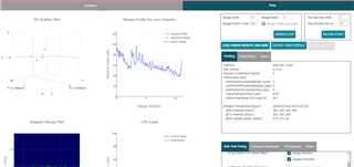

此外,在mmWave_Demo_Visualizer-4.2.0  Plots中,单独下载(LOAD CONFIG FROM PC AND SEND)配置文件(E:\ti\mmwave_mcuplus_sdk_04_02_00_02\mmwave_mcuplus_sdk_04_02_00_02\ti\demo\am273x\mmw\profiles\tdm)可以正常运行,请问哪里配置有问题吗,都是Demo的文件,没有修改过。
